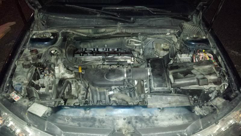

Picture of the Engine Bay:

Hi there. Sedre says the relay is in the engine fuse panel, and is run via fuse 2. The fuse panel is MUX...
I hope you didn't fry something when you were welding :(

So I got fed up, and towed it to the Peugeot dealer, and got them to find the fault. The had to replace the Fusebox in the engine-bay, because of some corrotion. It seems I got the model that has the fuelpump relay as a part of the fusebox and not a separate part. so that cost me aprox £360 to fix (with labour and fault-finding) instead of a relay that costs £32..
