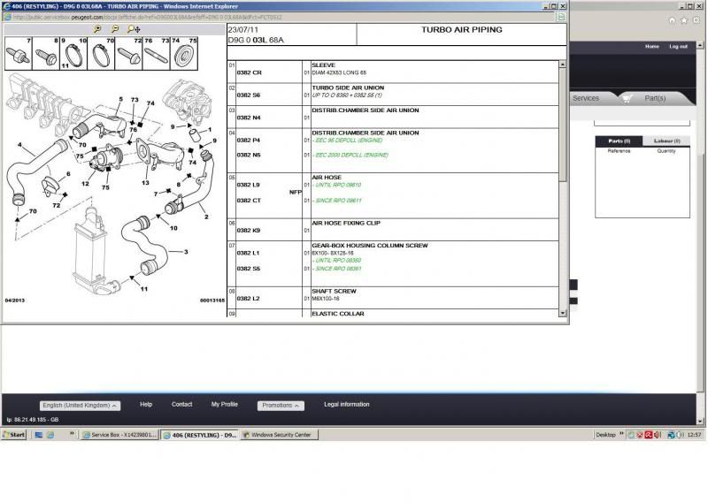

well I got till Tuesday to sort it out myself so I'm gunna have a go at the weekend see if I can find a leak or damaged pipe. I don't suppose any of you fine forum members would have some pics of what I'm lookin for it would help a lot. I've been using parts box but I can't find a diagram of the complete turbo system only little snippets. thanks again everyone
Re: rhz turbo lag diagnostic
This one should cover it. Depending on the age of your car, you will either have the simple air pipe, (5) OR the air doser, (12) and air pipe, (13).
Never had a 110, but I think the air doser was introduced around 2001.
