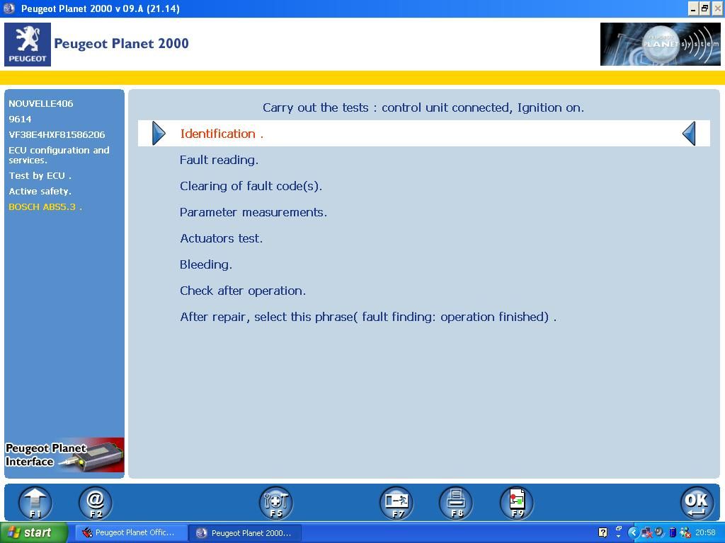

I think you can bleed it using PP2K, there's some sort of test mode you can put it into and it tells you which wheel to go to next. I'm not sure if it tells you when you need to tip more into it though.

If you have dealer diagnostic/service kit (guessing with Pug is PP2K, with Vauxhall is Tech2), then you can activate the ABS pump whilst doing the bleed, saves having to rebleed to make sure the ABS system is flushed.
