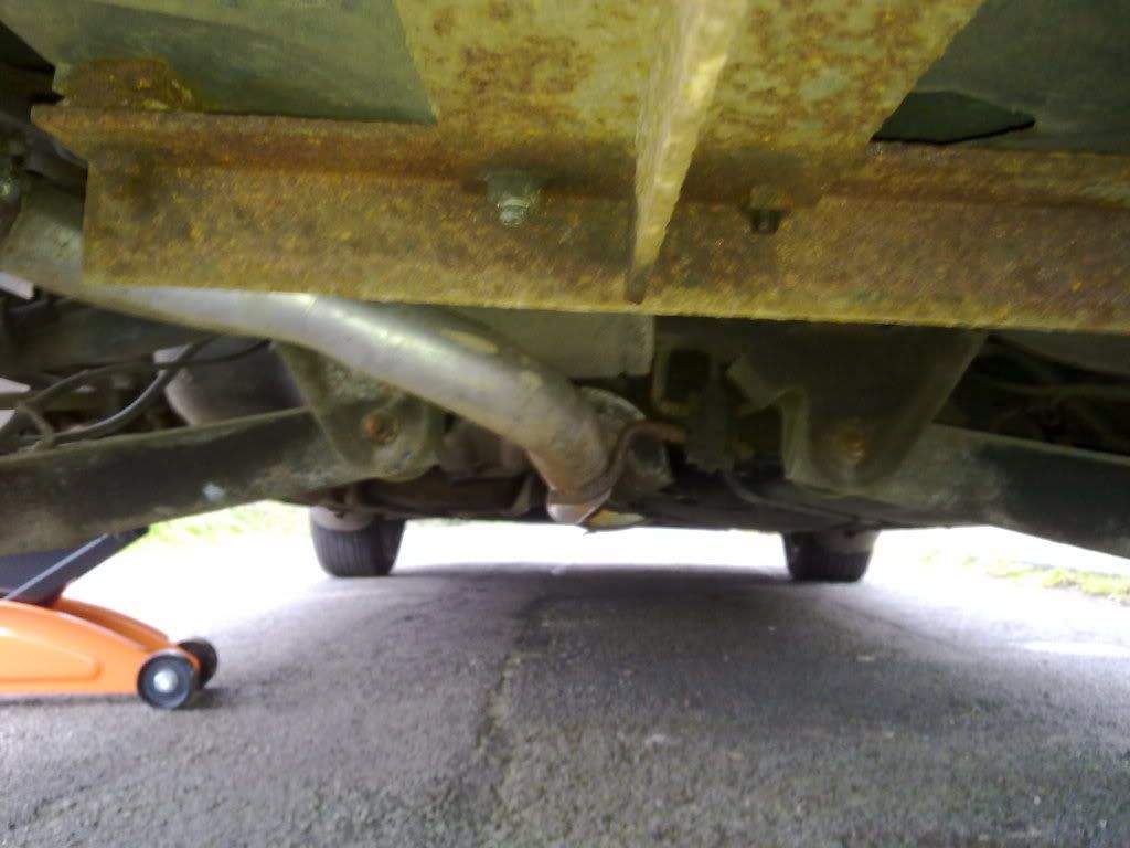

i cant see where to put the axle stands on my sri, where do they go?

Put your axle stands under the bottom of where the coil spring sits.

do you have a pic of where you mean? as im sure i tried that before and it just lowered with the car

jason1987 wrote:do you have a pic of where you mean? as im sure i tried that before and it just lowered with the car
In your first picture the position is right there in front of you ....the white coloured bit next to the camera.

the round mount in top left?

Yep that's it... be careful they are secure.

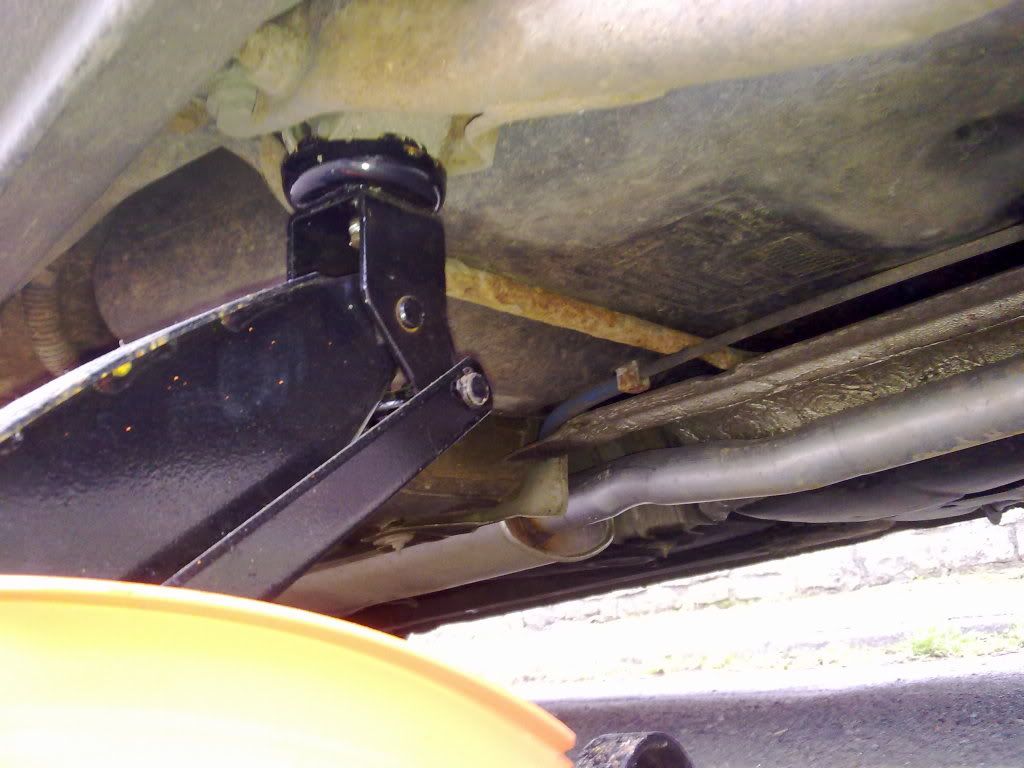

Re: where do i put axle stands on the rear of an sri? (PICS)
is that one of them Rac branded trolley jacks mate?
if it its watch them mate,
Mine started acting up after a few weeks,,
it gave way the other day luckily ihad 2 wheels under the car iwas working on ,
Mines now on the scrap pile :(

na its a halfords one, and in refrence to my other thread about the allen size on the top caliper bolt on the rears, i put a size 6 allen in and it seemed to fit, so does that mean its a size 6 i need or is it because its one size down from the 7 and the 7 will be a proper fit? just the caliper tool is £7 from halfords for a 7mm allen and dont wanna buy it if i need a 6, but everyones saying size 7
