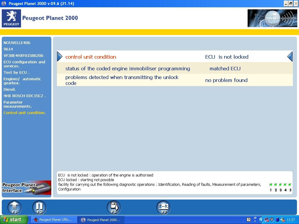

One other thought - if you look in Parameters / Control Unit Condition, do you get something similar to this?
In other words is your ecu letting it start?
Caught a couple of fleeting readings - engine RPM read 220 ish just before it fired, fuel pressure 185 Bar, but that was about all I could see.

Will have a look at that in the morning, although I am pretty sure I seen somewhere that the ecu is unlocked?

I couldnt find that screen Doggy, the closest i could get was this?
Sorry about the quality, i dont kknow how you copy the image to your computer??

I agree, it's certainly unlocked.womble171 wrote:I couldnt find that screen Doggy, the closest i could get was this?
Press shift+prnt screen, then open Paint, click Edit, then Paste. Save it as a jpegSorry about the quality, i dont kknow how you copy the image to your computer??
