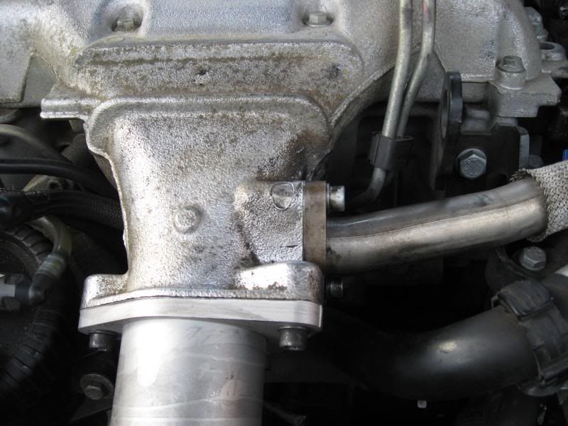

My gf's 406 hdi 2.2 is due it's mot next month, it has a couple of faults throwing the EML and the standard 'anti pollution ' fault in the display, (reading the codes I know at least 1 glow plug is out) plus the ESP light comes on at around 40mph. It had a blocked DPF earlier in the year which I removed and jet-washer back-flushed, and at the same time I removed the EGR and it's piping to stop any more crud being dumped in the intake. *touch wood* it has run fine since then.
Anyway, I was wondering if anyone has taken their slightly-modded Diesel through the 'new style' MOT and had issues? I've got a fairly relaxed MOT tester and as the glow plugs look like a right pain to access/replace my plan was just to clear the codes/EML on the morning of the test as iirc it doesn't come on again for 3 starts. I read they're supposed to check for EGR mods etc now, obviously I can put it back on but it'd be nice if I didn't have to!

Not had the 'pleasure' of trying the new-style MOT, but I'm not expecting any issues when it comes around.
Wouldn't worry about the glow plug issue, nearly all of them have a fault code logged for them and it'll start just fine at -15 without waiting for them to heat up anyway.
My egr mod isn't so easy to spot.....

I don't think the MOT man can remove engine covers and undertrays ( unless the rules have changed) so the EGR blanks won't be seen if the pipework is in place, but the lack of pipework is a little more obvious..

Regarding anything used for emission control like EGR valves etc only applies to visible components...anything the tester cannot see without removing parts is not required to be tested.
