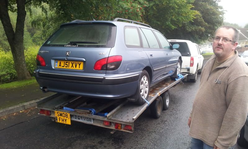

Good to see you again earlier :D . That was a long day, almost exactly 12 hrs from going to pick the trailer up this morning to arriving back this evening. I've been home just long enough to have some paracetamol and a Chinese.
So here's the old girl just about to leave her long term home in the valleys (the dodgy looking character is my very good mate Mark who has kindly driven over 450 miles for me today in his Navara, my new hero!)

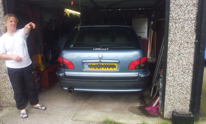

And here she is safely stowed in her new home.
That's a hell of a list, as you say there are probably some red herrings in there (I think the TPS is one). The main fault has to be the fuel regulation issue as that was the original one. Some of the other things, such as the keys, are going to be a result of standing for so long (I hadn't actually locked it for over a year cos it's been locked in the garage, so the keys probably need re-syncing or perhaps the batteries in the fobs are flat?).

That's one hell of a day, thank you for making the effort :D
I'll get everything working eventually! The central locking works fine off the keys so the fobs just need some TLC.
We did well to get the car into my garage, it isn't easy driving into there even with a fully working vehicle! I expect you are happy to get your garage back :D
One advantage of having the estate in my garage is I can store stuff in the back :D
I'll keep you up to date and let you know when it runs.
Just gave my wife a shock to see her photo on the forum :D
