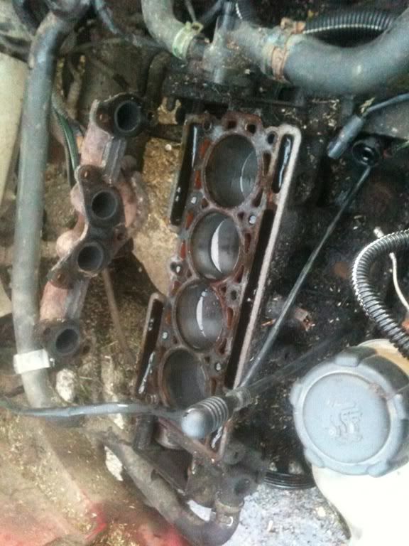

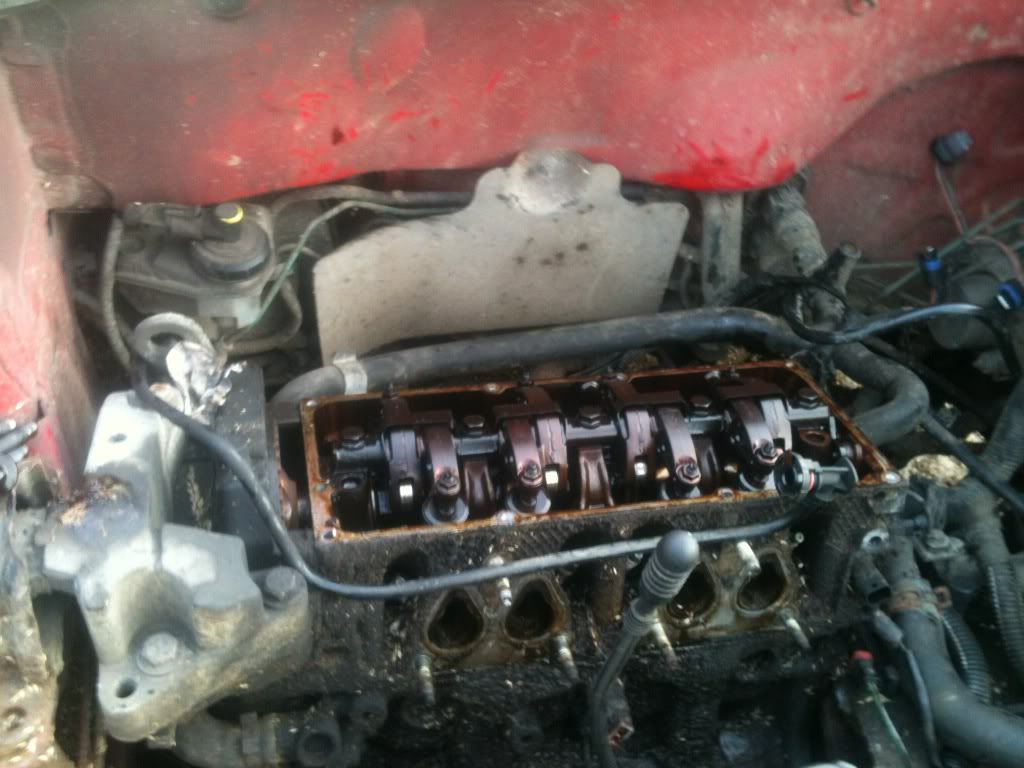

i just started to disassemble the engine, got as far as the head off it, its a very dirty engine, even compared to the old tractors we have the engine is caked in oil.

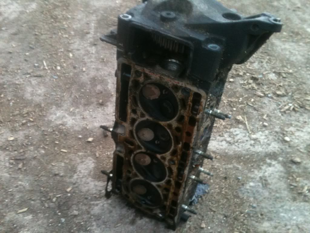

What does the white on the top of the valves mean?

White on the valves is carbon,
it will clean off,

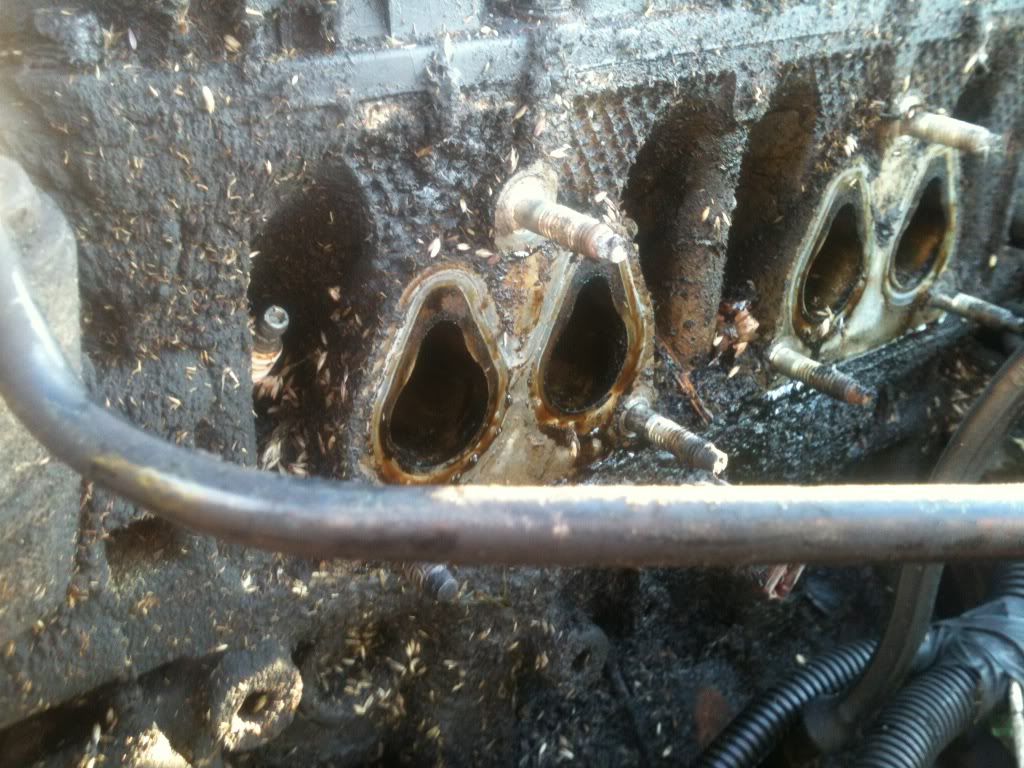

What do you think all the oils about, the crankcase breather pipe was fairly clear, but the air filter was so saturated in oil it felt spongy, any chance the head gasket was on its way out?

ithink renaults are common for oily engines,
it will clean up with paraffin, or Jizer gunk etc,
