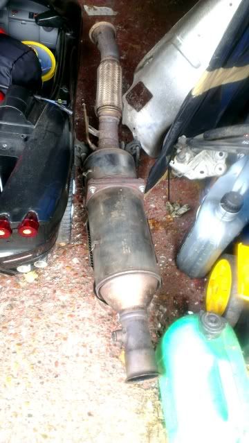

Thanks Doggy, Can't I just un-bolt the DPF, and get a friend to weld up?Doggy wrote:In the pics, it looked like the middle pipe was a goner and the eBay advert stated the back box had failed too. I would change them & knock the FAP out. That's probably all you need to do.
Removing the cat element would be damn near impossible without taking the housing from the car to do it and in my experience it doesn't make a blind bit of difference, (other than making the exhaust fumes smell like a 1960's double decker). Your flexy may well be alright, but equally might not survive the unecessary trauma of bashing out the cat element too. If it turns out the flexy is leaking you've lost nothing as all the bits will separate again easily if need be.
Mine still has it's cat and seems go not too badly, by all accounts.
Definitely need that middle section and back box then....
Miss Pug 2001 - 2023.

Re: I JUST BOUGHT A NEW CAR!!!!
Here is mine when off the car recently.
Although the canisters appear to be stainless the pipes appear to be mild steel.
