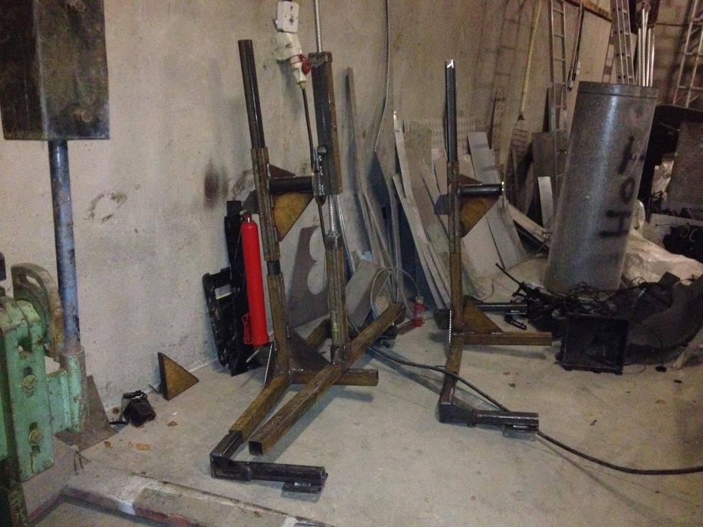

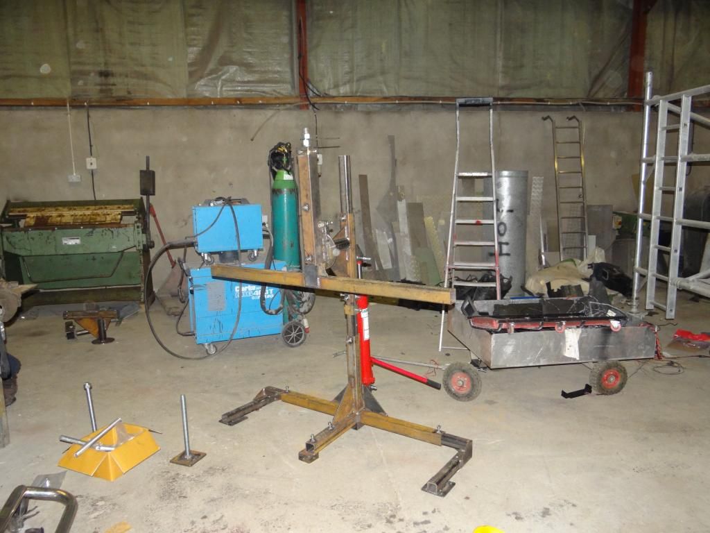

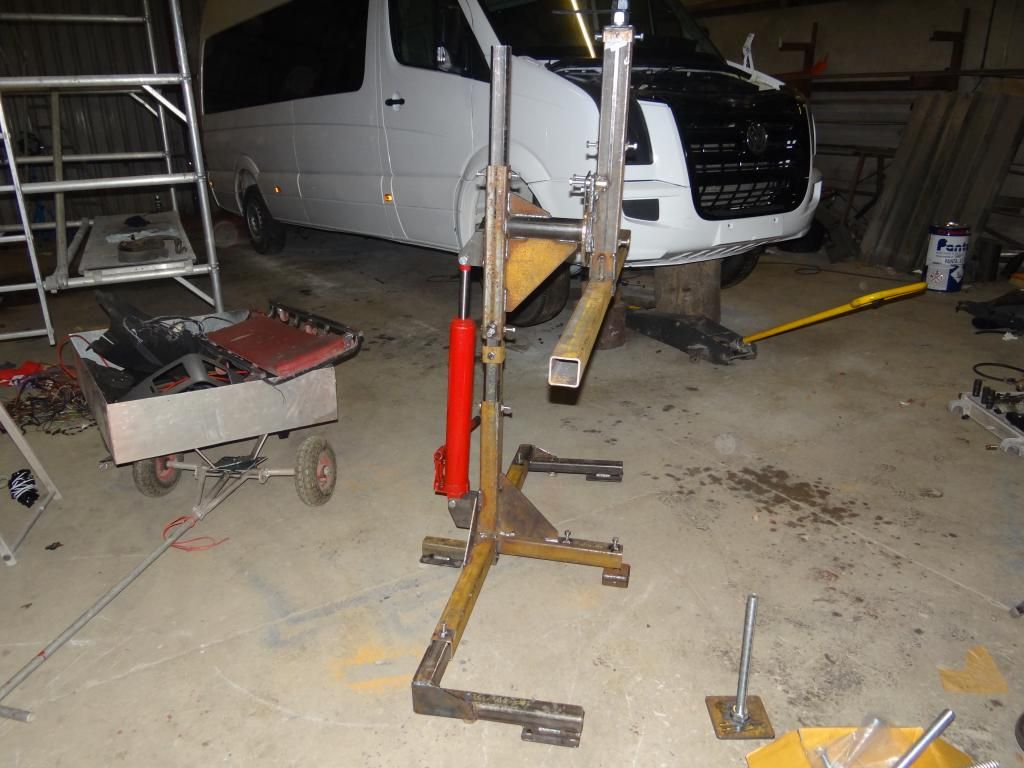

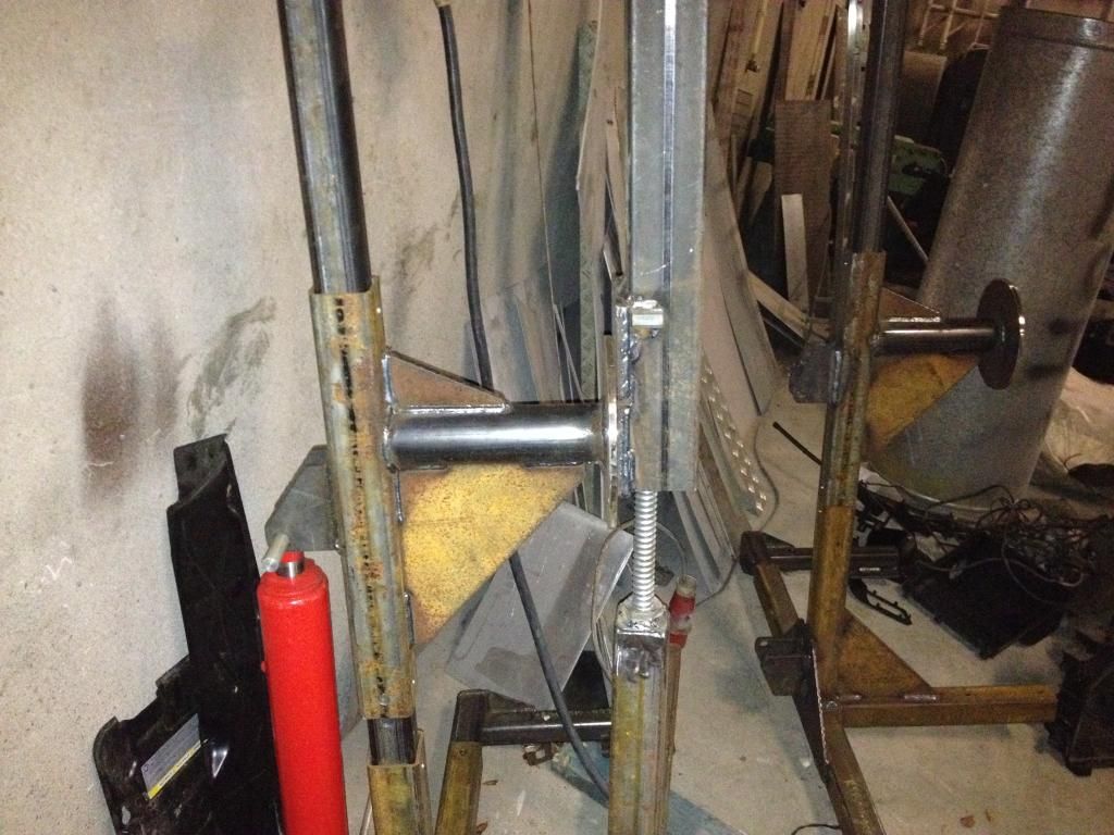

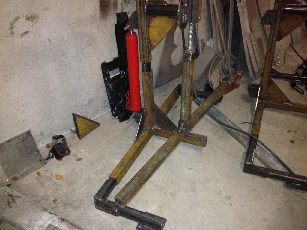

Last year (ie yesterday), we got a bit of the rotissarie started all the box has been drilled out, and the two bases are welded up, my cousin had a good idea to change the layout of the box on one so that the central bit of box that will join the two rotissarie sides will be able to telecope in and out, before this it would have meant one bit of box to suit each car:
Re: 1985 305
Ah, splendid
I suppose the alternative would be to make it long enough to take anything you'd be likely to stick on it,..
Re: 1985 305
Initially my plans were going to have it so that the bit of box section would be cut to suit the length of the 305, but the main reason for the adjustable head is so that it can be used on other cars, now with the connecting box being able to telescope in and out its that bit easier to adapt to different cars, one central bit of box suits all.
Its all theory, i wont know how well it works until its all together, its based off existing plans but its had quite a few changes after different suggestions were made.

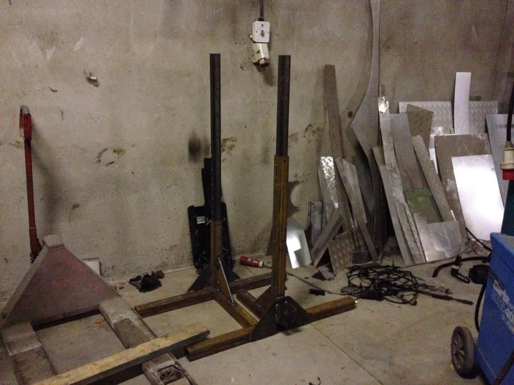

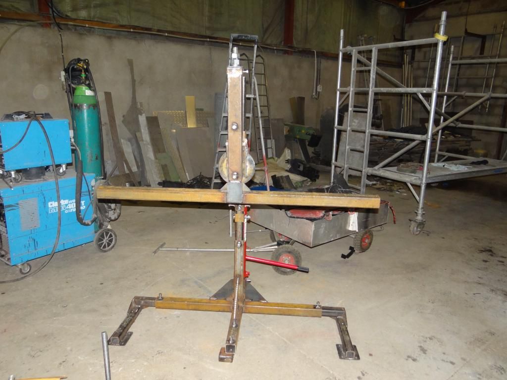

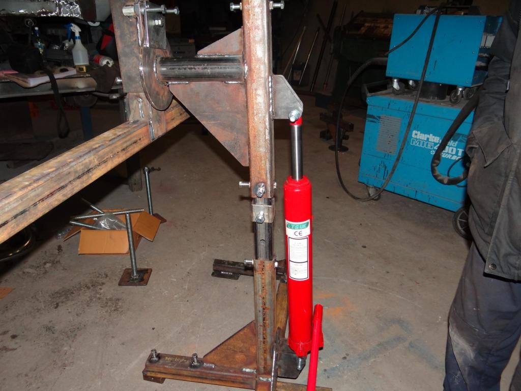

Got a bit more done to it this evening, the rotating heads are both made and a few other bits it's looking more like the finished thing, tomorrow should finish it off:
Re: 1985 305
Looks like some nice neat weldage there

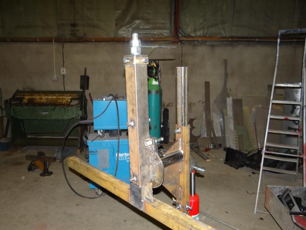

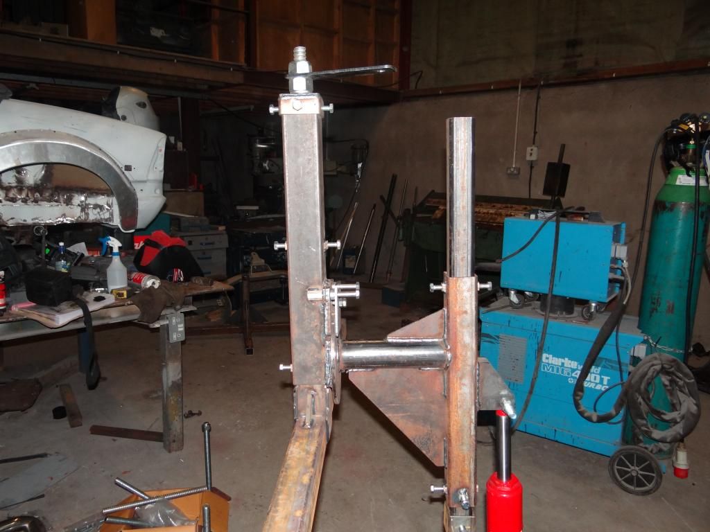

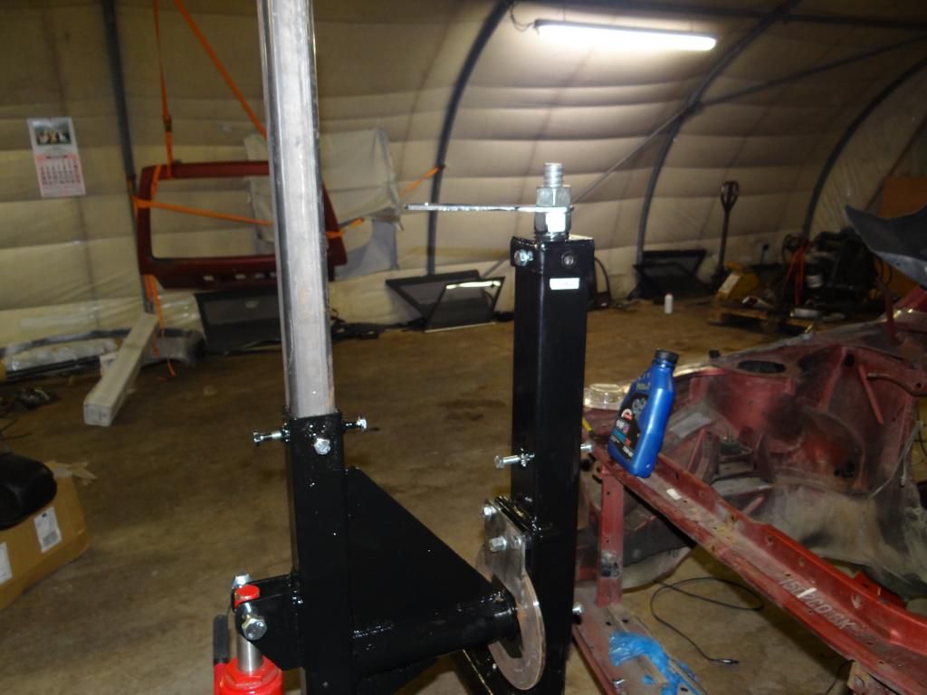

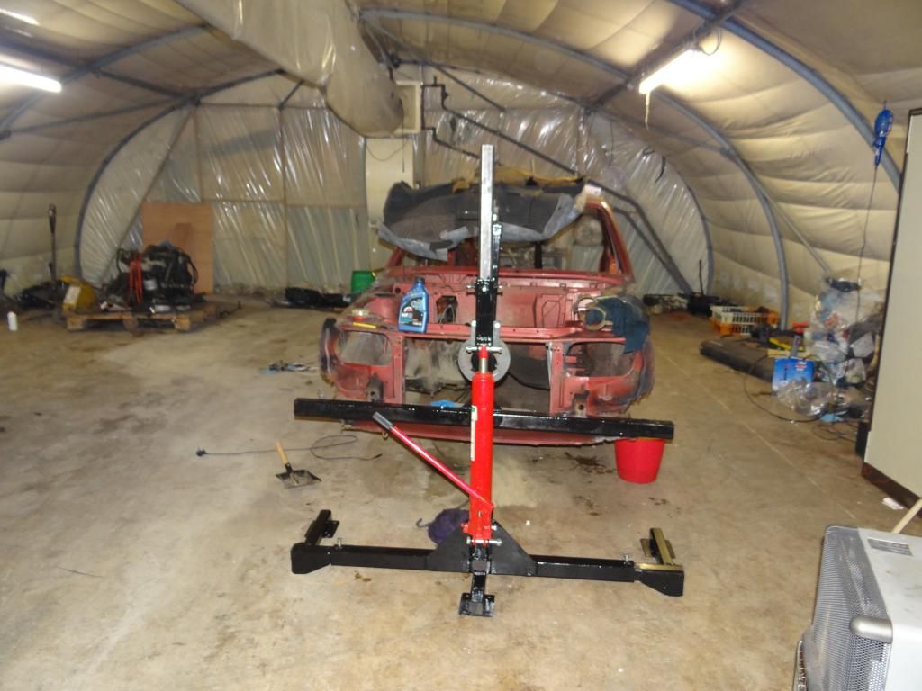

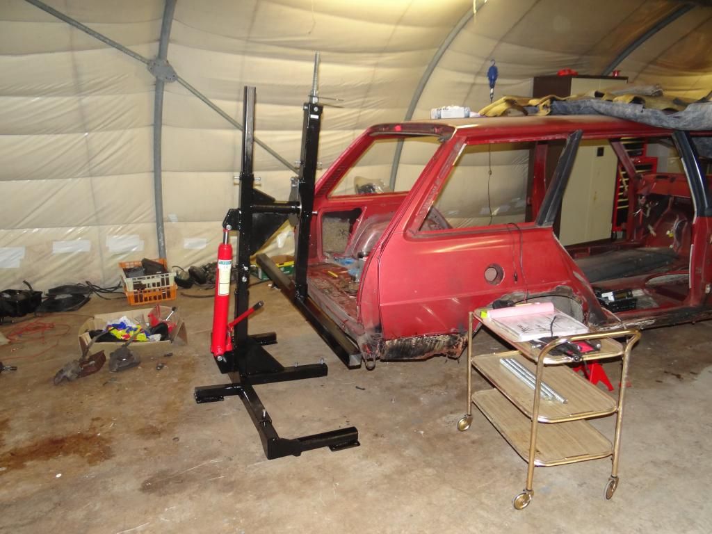

The rotissarie is complete, or they will fit together now, i need to strip them back down, chip off the bird shite (weld splatter) give them a coat of paint and add the castors, here is one side finished:
My cousin gerard who welded it up:
Re: 1985 305
Excellent! you're becoming quite an engineer I think, well done so far.

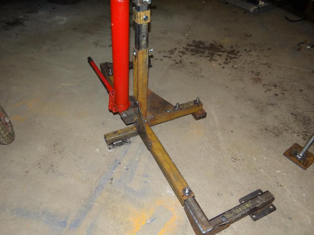

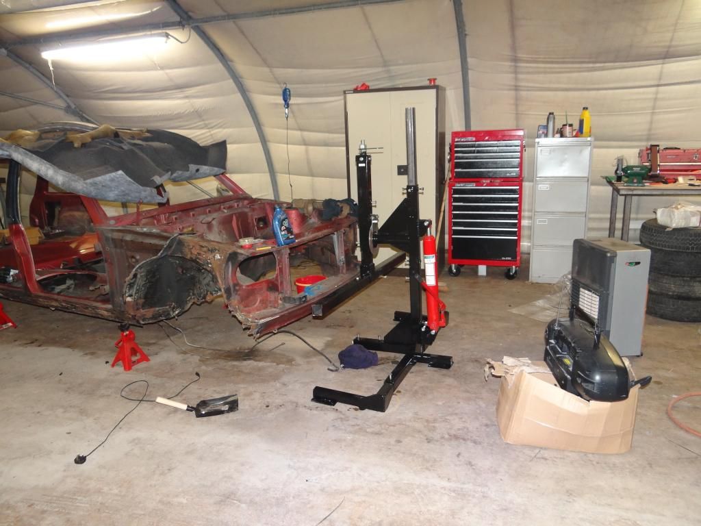

I painted the rotissarie with a bit of direct to rust paint (not hammerite) its not free of brush strokes but it will keep the rust away,
Rust must actually work as a primer? the parts i smoothed the rust off with the angle grinder the paint did not stick well onto, but the rusty parts the paint went on nicely.
Just some adaptors to make up to attach it to the car, find some castors , and handles for this:
i want a spinning handle thing that bolts into place, i had a look on ebay but dont see anything that would work i dont know what search term to use, any ideas?

Looks really really good, A+....
Will you be fitting castors with brakes as I can imagine a Mr Bean moment waiting to happen when you try to revolve the car..
As for the handle, what about those things that clip onto steering wheels for lazy drivers..??
http://www.ebay.co.uk/itm/BLACK-LEATHER ... 51bba75324

Wow! That's fricking wonderful
nicely done!
