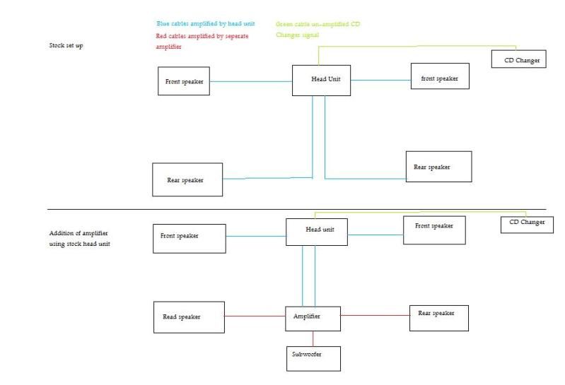

Currently, all your speakers are being amplified by the head unit itself.If you'd like to add a subwoofer and amp to your setup without changing the head unit, you can.
Almost all amps support 2 types of input: High level and low level. A low level input would be provided by a pre out on an aftermarket head unit. A high level input uses a signal that has already been amplified - I.e the exact signal that would arrive at a speaker.
In your case, the standard head unit doesn't have a pre out, so you'll need to use the High level input on your amp. Essentially what you'll be doing is to disconnect the rear speakers and send the amplified signal into the amp instead of to the rear speakers. Once the amp has the input that would have gone to the rear speakers, it can send it back out to the subwoofer, or in the case of a 4 channel amp, it can send one signal for the bass to the subwoofer and a second normal signal to the rear speakers.
As I've the affluence of a dead badger in a foreign country, I've drawn a little picture to help explain:
Note that despite being a 4 channel amp, there are only 3 signals coming out. The signal to the subwoofer needs to be bridged - there's usually markings on the amp to show you where to connect for a bridged output.
