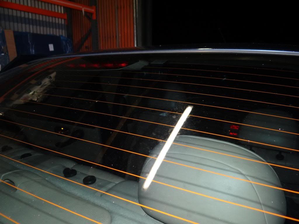

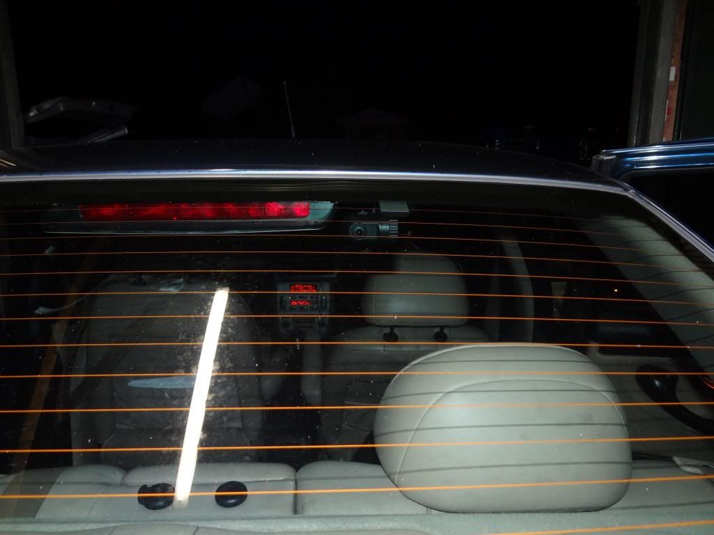

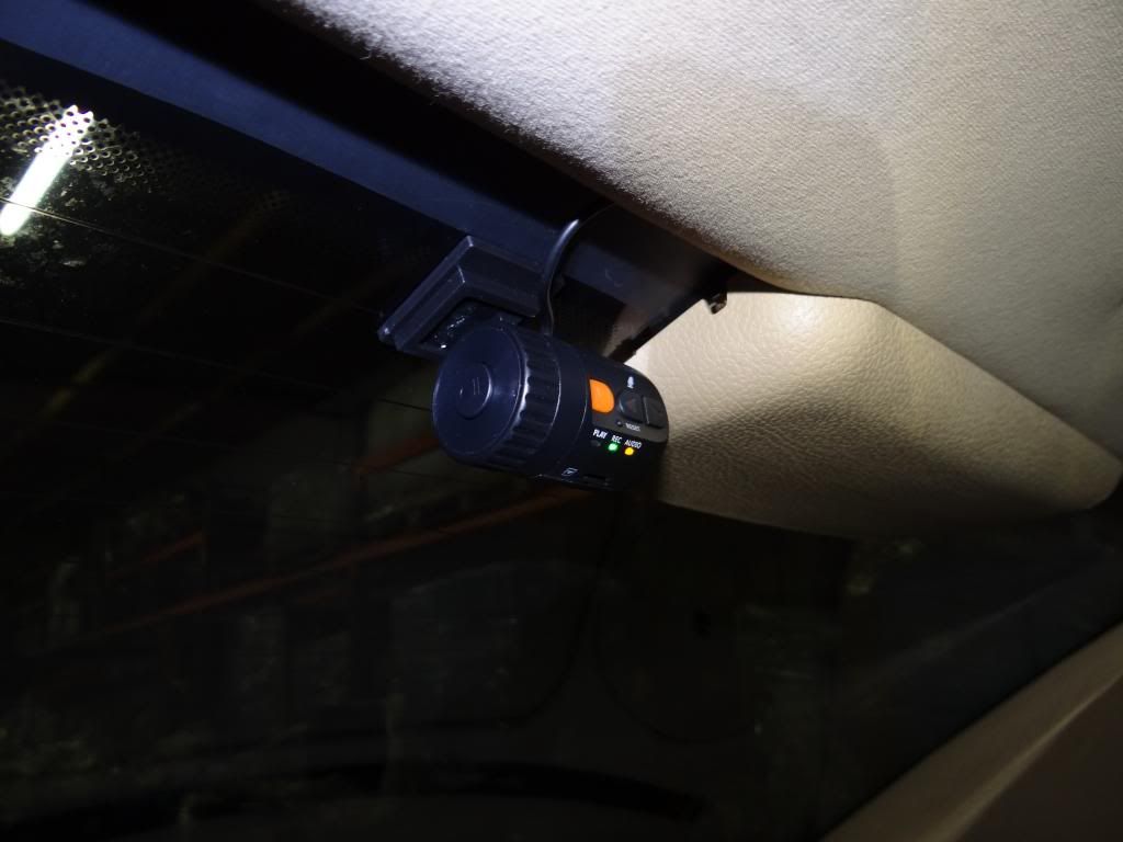

A cheaper £20 dash cam arrived today from china, it arrived rather slowly in a bit over 1 month, i mounted it up beside the 3rd brake light:
(it shows up with the camera flash turned on, normally its much better hidden)
It sits there unobtrusively, there is more than enough wire supplied with it to reach the B pillar where i soldered it to a 12v wire, it uses a tv component lead to connect to a tv, which would be used to change the time and date, quality settings etc, a small portable tv would be useful for setting it up and getting the angle right, then once its set up hide the component lead in the B pillar and return the tv to whatever room of the house it occupied.

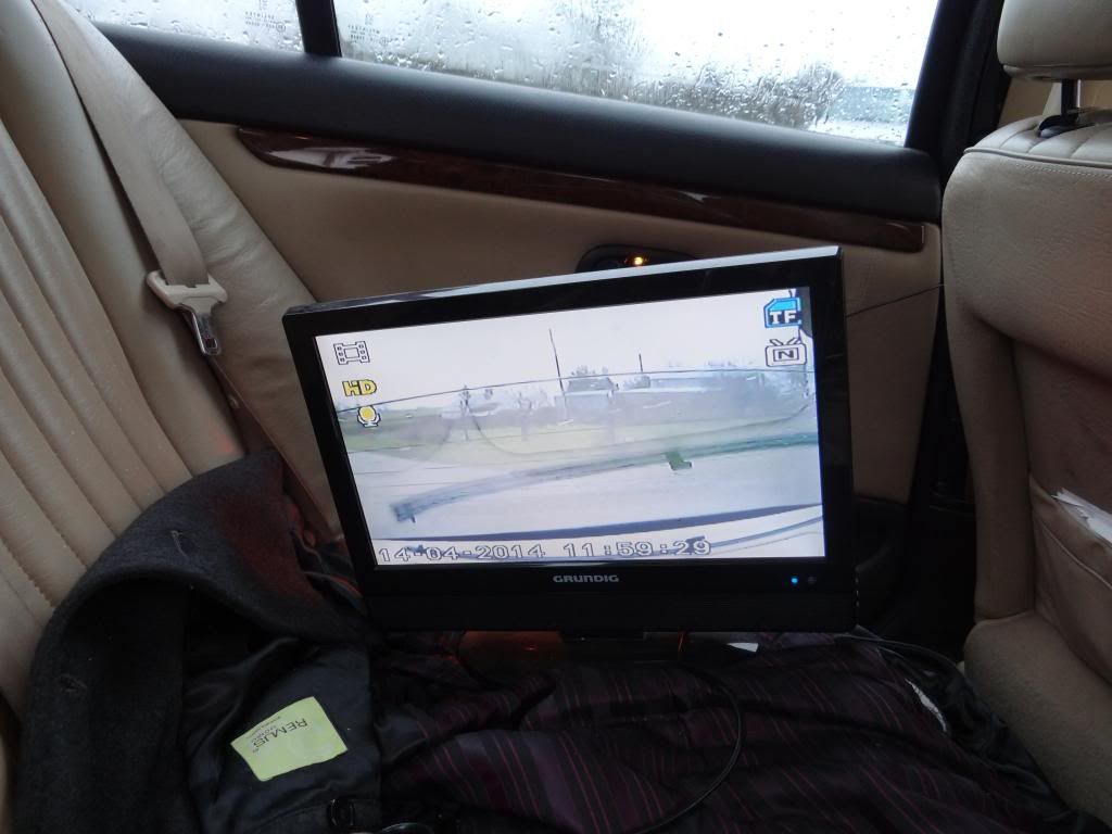

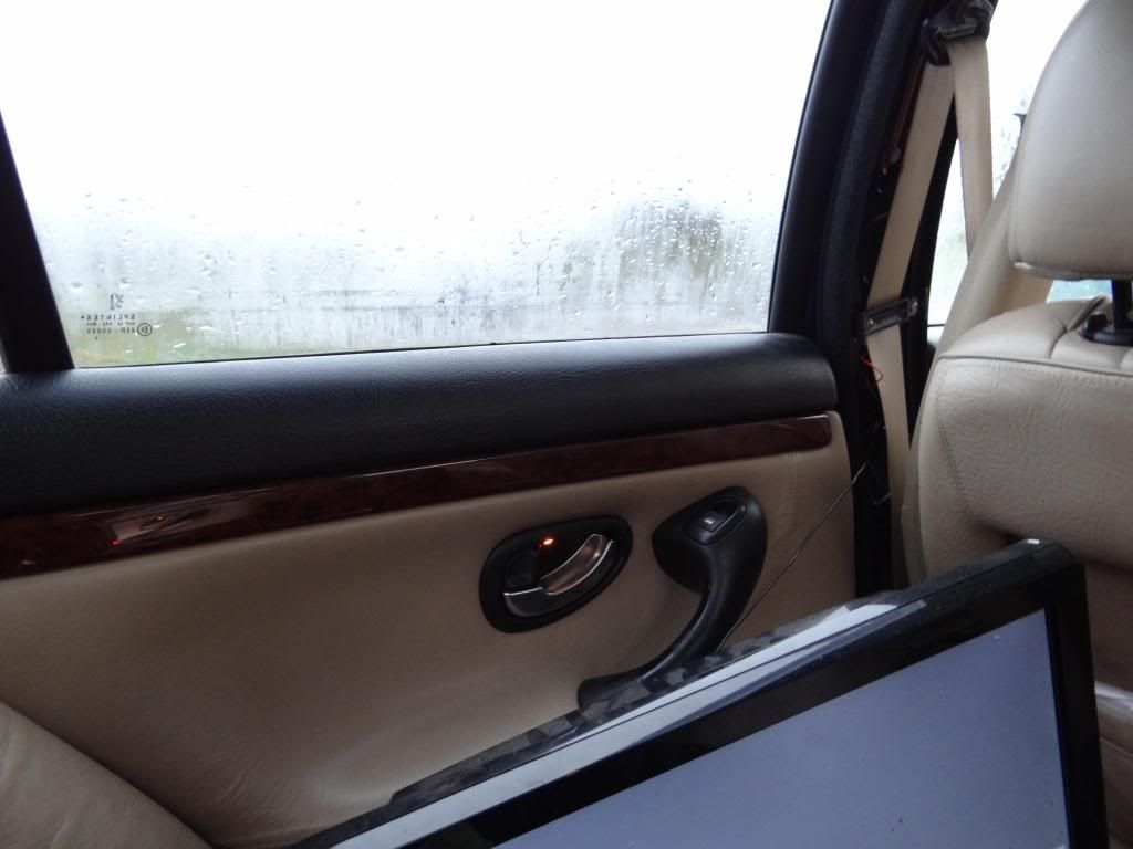

I keep looking at the first pic there and can't work out what I'm seeing instead of the inside of a rear passenger door :? is that just an optical illusion? :?

Thats a brick wall with damp spots visible through the open rear door.
Its not really an 0801 clone, this camera is called an A8, a lot of the cheap 720p dash cams on ebay look like it, the main reason for buying this one as opposed to them is that it has a rocker switch to turn the audio recording on or off. The other ones you need to manually set it to record sound every time.
The 0801 on the other hand has the LCD screen, records in 1080p, and has the option of GPS, but both do have the same "bullet design" i think this is the best setup for a dash cam, it makes it compact and it can still be adjusted. Any of the dash cams that use suction cups get a bit big looking.

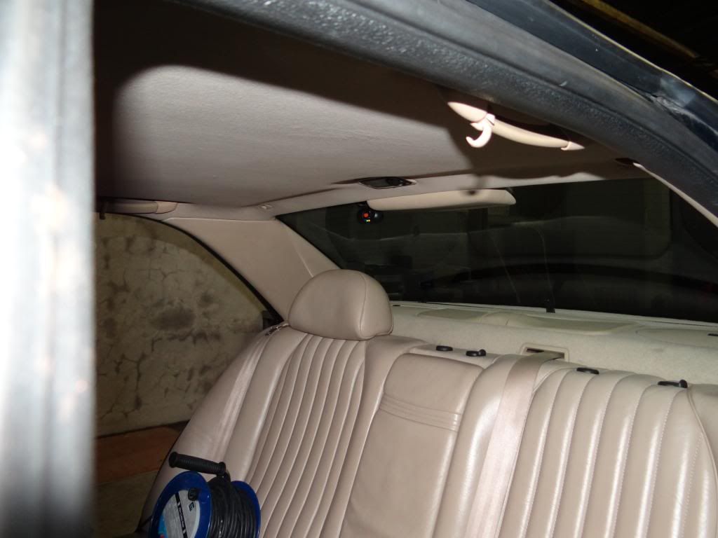

I got the tv to setup the rear A8 camera today, mainly the time and date, as well as checking that it was angled correctly, to do this i have to remove the B pillar trim and hoke out the lead and connect it to the TV (the tv was powered by an extension lead from the house):

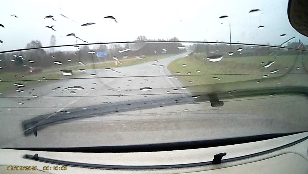

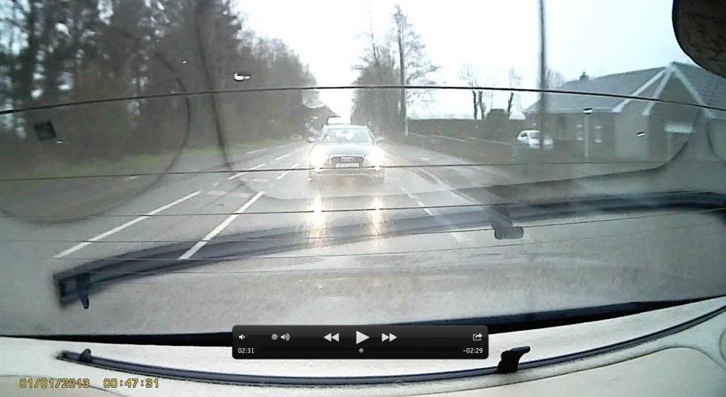

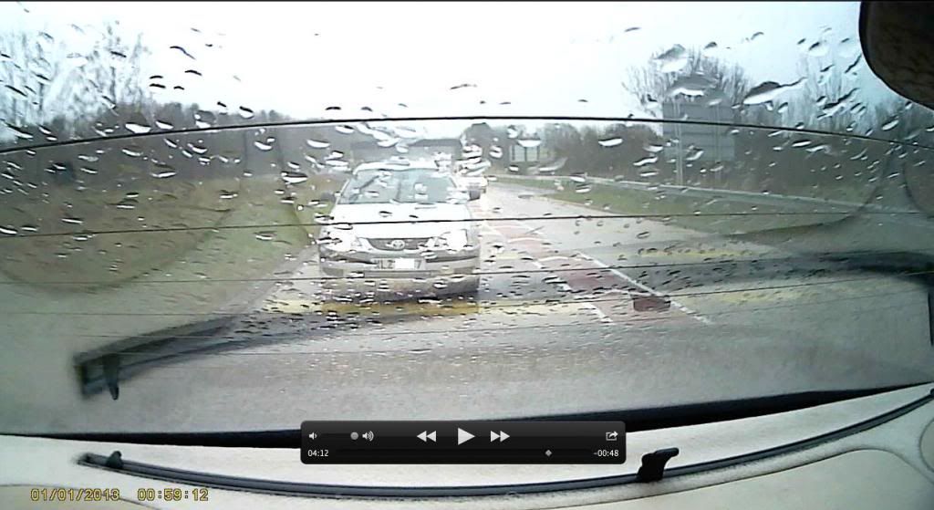

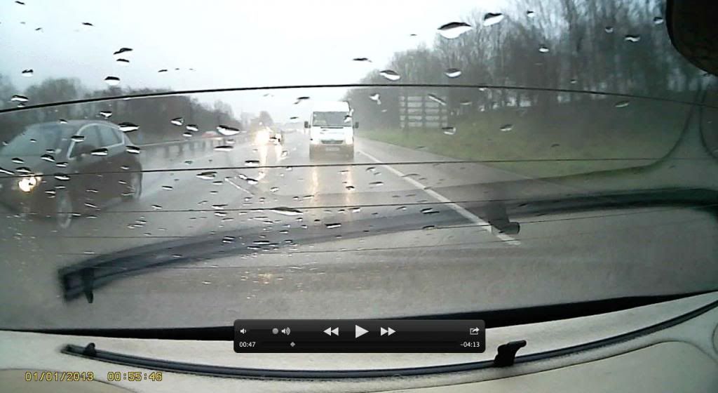

I don't want to upload a whole video right now, but here is a few screenshots of the footage i got today, i drove my grampa to ballycastle as he bought himself a yaris to replace the polo.

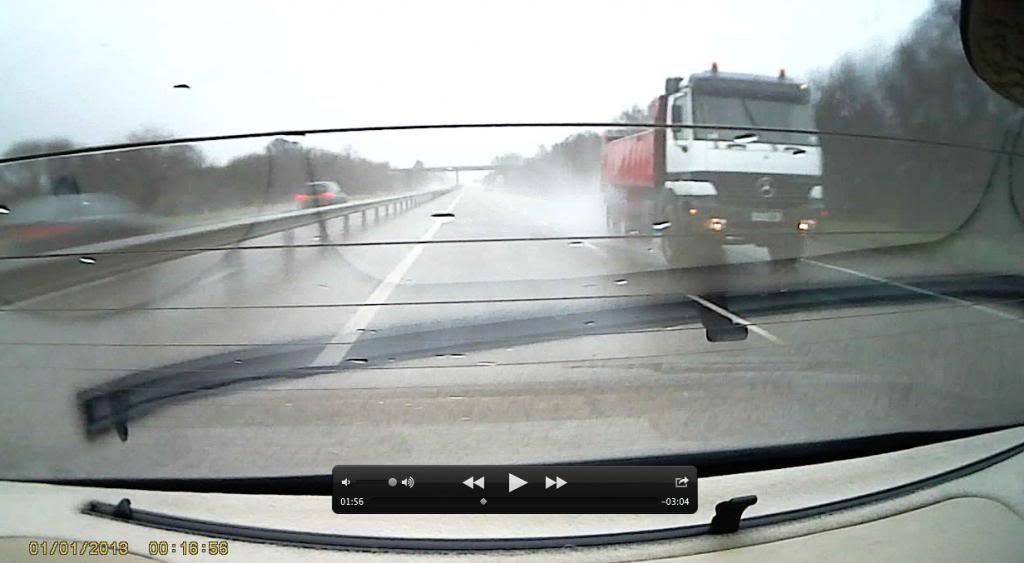

Is anyone surprised that one of these appeared in the footage:
(this car was sitting behind me in a queue for roadworks, it needs to be this close before the plates can be read)

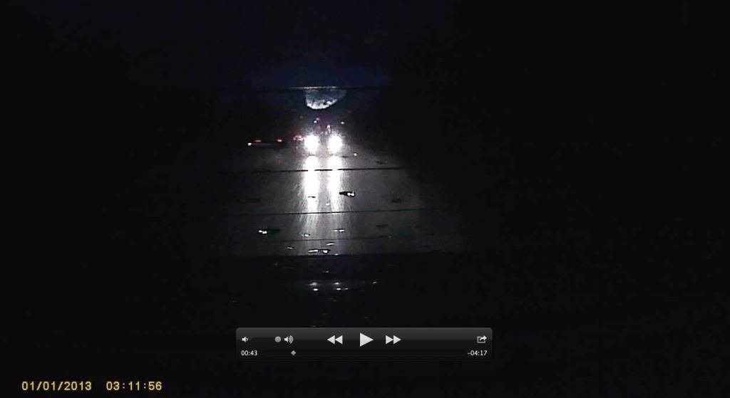

(a night time shot, a bit crap to be honest)
After watching the footage back i can say: the image quality is not as sharp as the 0801 but thats expected as it only records in 720p that does mean that you can only really see number plates if the car is very close such as queuing at traffic ligths, night time footage isn't great, its ok in well lit up areas such as towns or on roads with street lighting.
It doesn't seem to remember the date or time, thus rendering the whole exercise with the tv a waste of time. But it only cost £20, and it might just see something sometime which could be useful.
