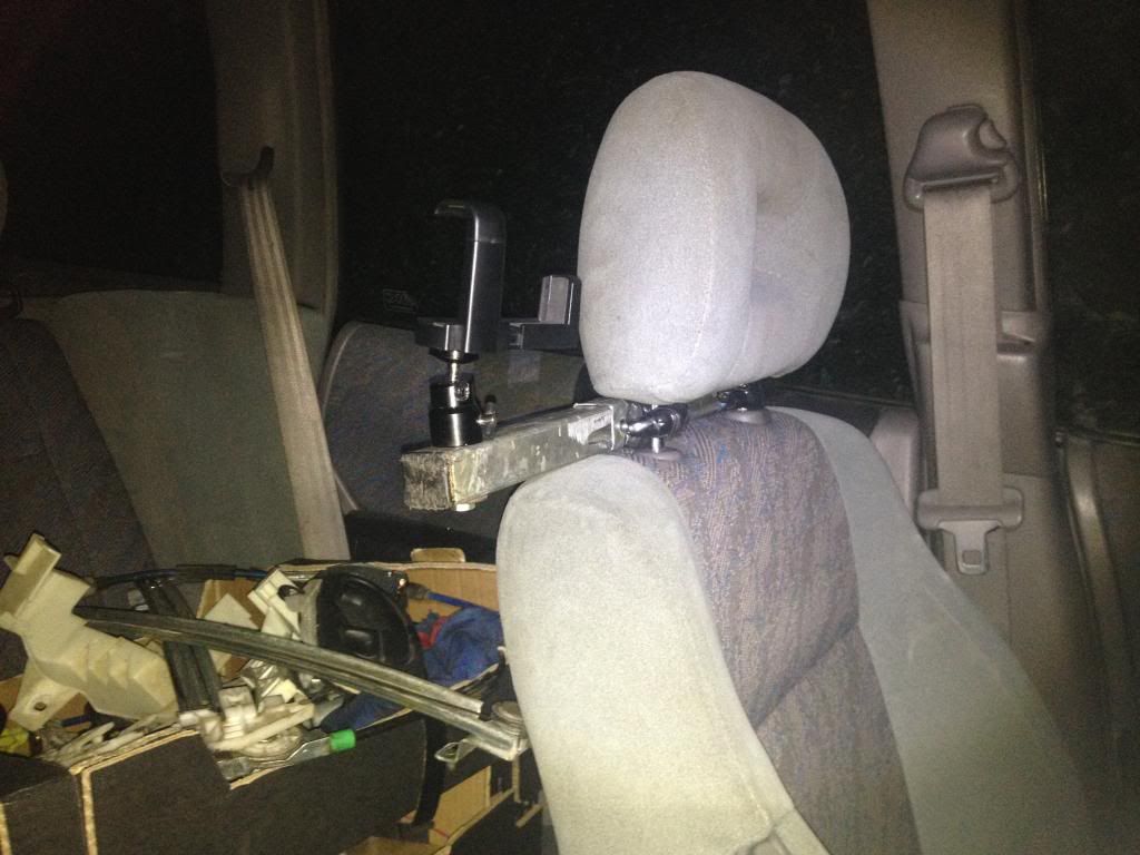

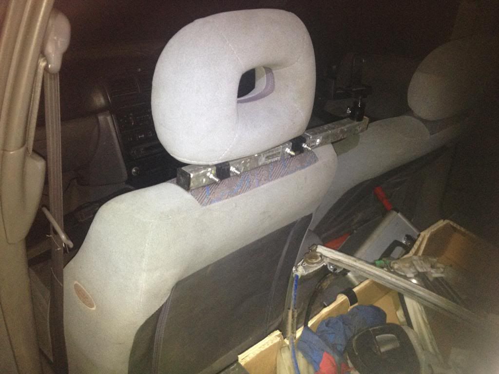

I made a headrest mount today (mainly for the subaru but it should be able to fit into any car) out of a bit of the box section used for the shelving in the mushroom houses, a cheap camera balljoint off ebay and a universal phone tripod holder:

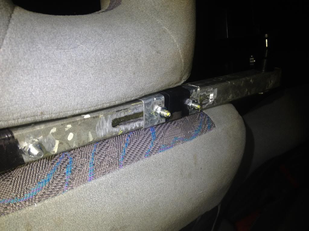

It uses a pair of U bolts to clamp onto the headrest, one is fixed into place, the other is adjustable so it can be used in different cars:

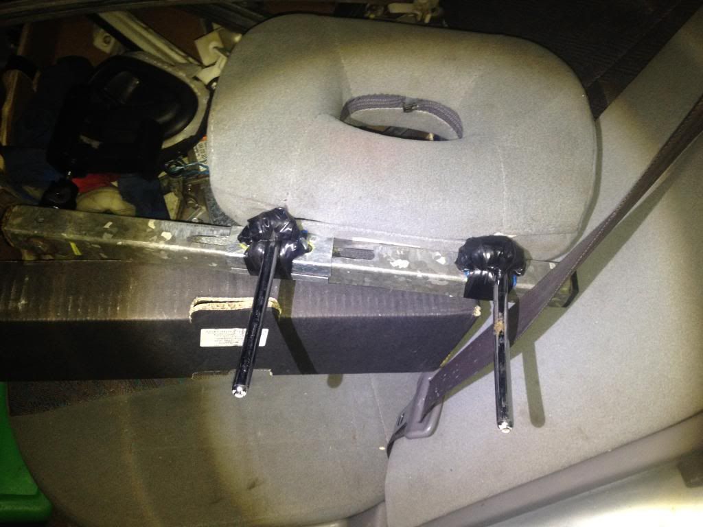

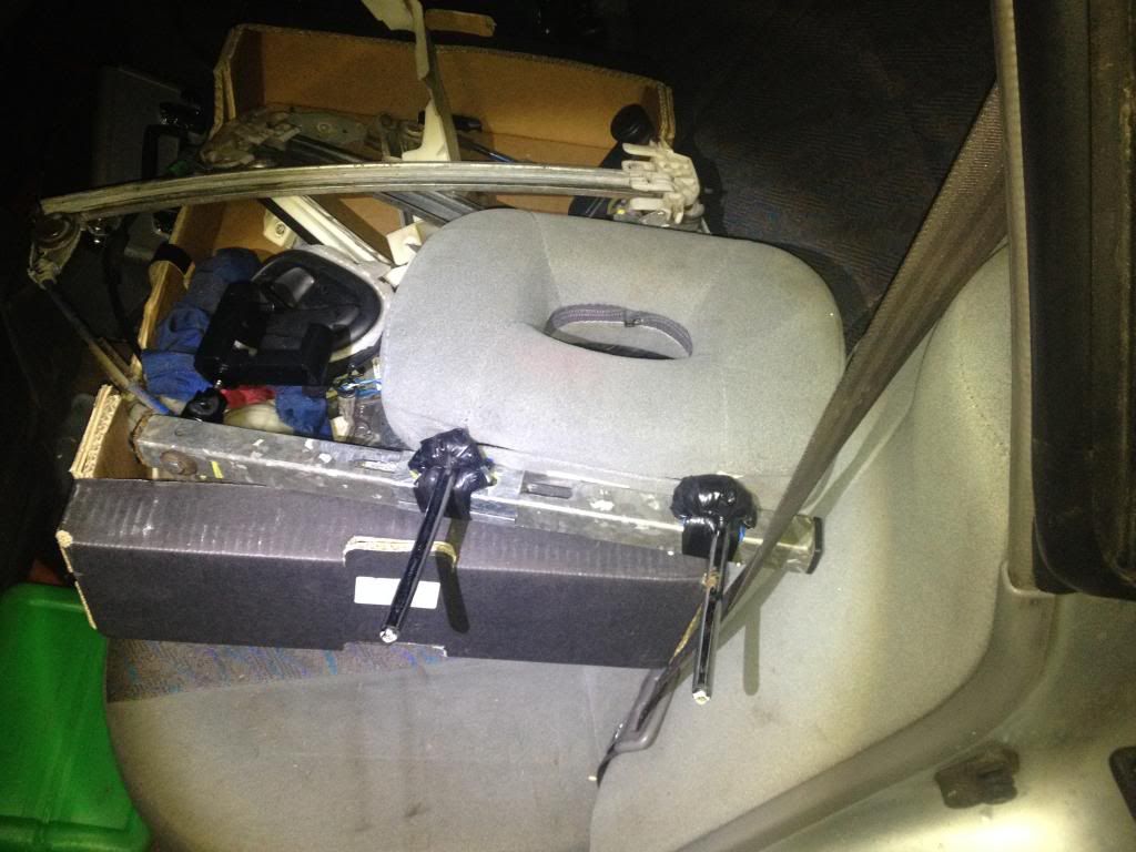

A bit of old glove wrapped in tape around the U bolts was used to give a bit more grip onto the headrest poles, a bit of hose might be neater but this is cheaper:

Is this for the dash cam or for holding a proper camera while you're driving?
Re: Dash Cam
Its for holding a proper camera when I'm operating the subaru, Ive had it in a ditch a few times recentlysteve_earwig wrote:Is this for the dash cam or for holding a proper camera while you're driving?
But i also wanted to make this to hold a camcorder inside a car instead of trying to use a tripod and making it sit still.

Erm, I wouldn't like to be in a crash with that attached, cant help but think it would end up straight through my neck!FarmerPug wrote:I made a headrest mount today (mainly for the subaru but it should be able to fit into any car) out of a bit of the box section used for the shelving in the mushroom houses, a cheap camera balljoint off ebay and a universal phone tripod holder:
Re: Dash Cam
Its attached very solidly to the headrest, the bar itself has plastic caps on each end to prevent it going through necks. The iphone might fly out during an accident due to the design of the mount but a normal camcorder could be used instead.
