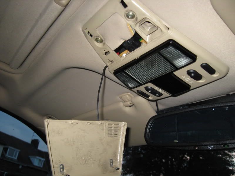

I'm pretty sure it's controlled by the BSI. Coolant temp sensor is the one with the green connector on the thermostat housing (over the clutch). Passenger compartment sensor is in the overhead console, it's a small clipped in gadget with a tiny fan inside.

Coolant temperature sensor will be engine coolant, I think it'd say refrigerant if it meant the one in the evaporator
There's a little fan inside the cabin temperature sensor to draw cabin air over a thermistor so the climate control knows what it's about. The fan is about 15mm in diameter.

To get to the passenger compartment air sensor, you need to gently pull down on the part with the grill, then this will expose 2 screws which hold the fan in place..

Between the sunvisors is the interior light unit. Part of this has a grill on the left - pull this half downwards.
Re: Pp2000 AC unit
Sensor is a little bead thermistor that lives just above the tiny fan.
Usual 'fix' is to get a straw & blow all the gunk out of the fan.

Yes.. I saw it this exactly mine with same interior n sunroof(but mail rail is broken, now the roof don't open).. So the code. Clear after I remove the connector n put it back..cheers mate
