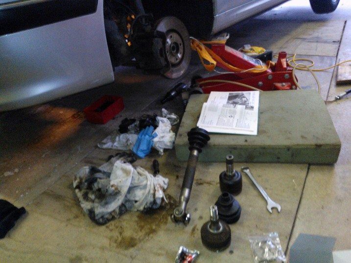

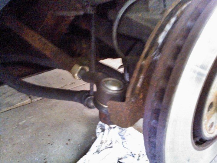

Been doing a bit of work on the old girl over the last couple of days including 2x track rod ends, n/s inner & outer driveshaft gaitors, handbrake adjustment, rear door lock mechanism replacement. Having a good look around the car all seems to be ok, does anyone have any other suggestions of failure items to check for that are common on the 406?...
