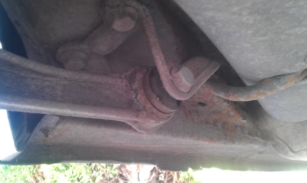

I've just been outside to look, bearing in mind this car has been to many garages etc,
Now I took it around the roundabout as fast as the car could go and then limped it back home put it up on ramps and came across this, Now I know the links do adjust the camber I can hopefully replace this arm (Both sides) and then take it to a NEW :shock: camber adjust place and.. well fingers crossed the kids are safe again
so I apologise for saying all the bushes we're changed because this bugger got passed me, although it feels solid it must move under pressure ( i hope)
Please confirm this could be my problem or i'll cry :cry:

Re: HELP
Could be... :shock: :shock:
