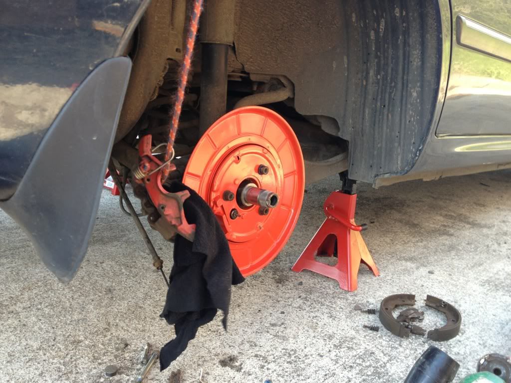

got my backplates back from the zinc-plating company.
Here are the pics.
The chaps did say that the plastic coating that was still surprisingly good but couldn't tell at first, was a bastard to get off - even after shot blasting. Maybe FP's new ones will last a while without further treatment?
Sadly the shot blasting put a hole in the backplate, will patch this up before fitting.
May still spray them to protect them further??

I fitted the plates today, but while i was there decided to change the rear shoes and pads, then decied to change the rear disks as they had plenty of grooves.
All was going back smoothly, but the rear passenger side callier seized, to unseize it i tried to put it in place with the pads on and press the pedal, but i forgot to put the drivers side rear calliper on with rather disasterous results, brake fluid everwhehere, and said calliper is wrecked, currenlty off the car and i have no way of stopping the leak other than a tray to collect the fluid.
An eventful day, but the plates look tidy:
