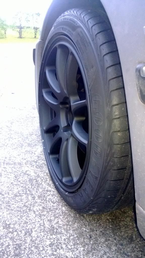

Yer like DDD said, the main thing to look out for is the width/placement of the wheel, if you are going wider, you have to decrease your offset.
I run 17X8" wheels with 15p offset on 215/45/17 tyres. This IMO is a seriously good size setup, very good for handling and looks the part.
I was thinking of running 18X9 or 17X9 wheels but I would have to be on about 5p offset or less.
If you car isn't lowered and the law allows it, try go for the lowest offset possible.

Re: Upgrading alloys
Ive got a set of 18s with 22540 18 and they sit nice no spacers straight fit at pugfest out of us lot and the coupes I was the only 1 with 18s that didnt need spacers
I was at Pugfest with my Coupe, I've had 18's on for over 2 years and I don't have spacers either.....
No spacers required here either. Like I said earlier its ALL about the offset
