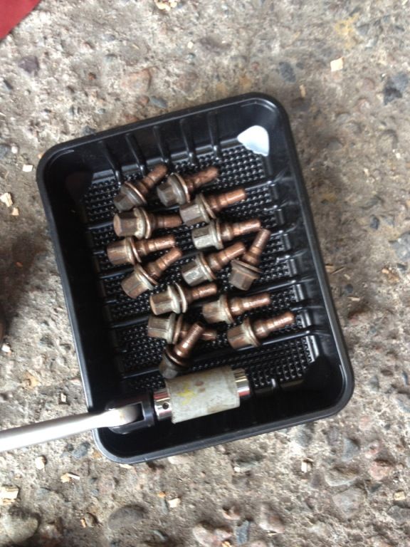

I got a set of the correct wheel nuts from my local breakers £10 for 16 of them, a quick wire brush and some copper grease had them ready to go on:

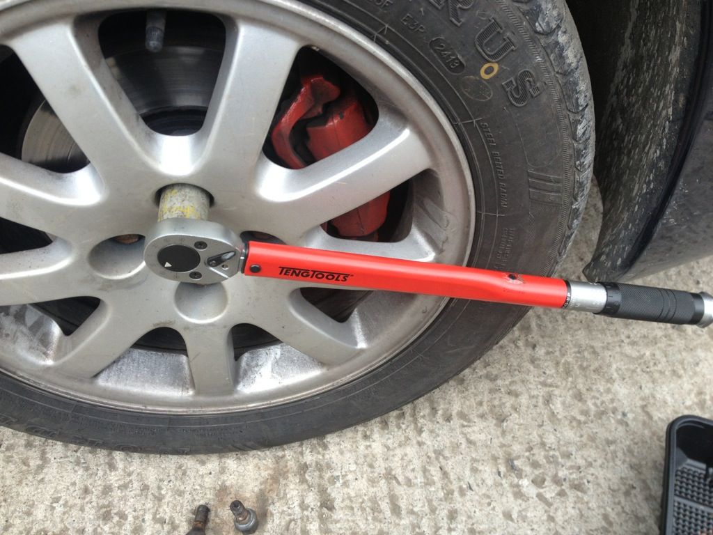

All torqued up to 90Nm:

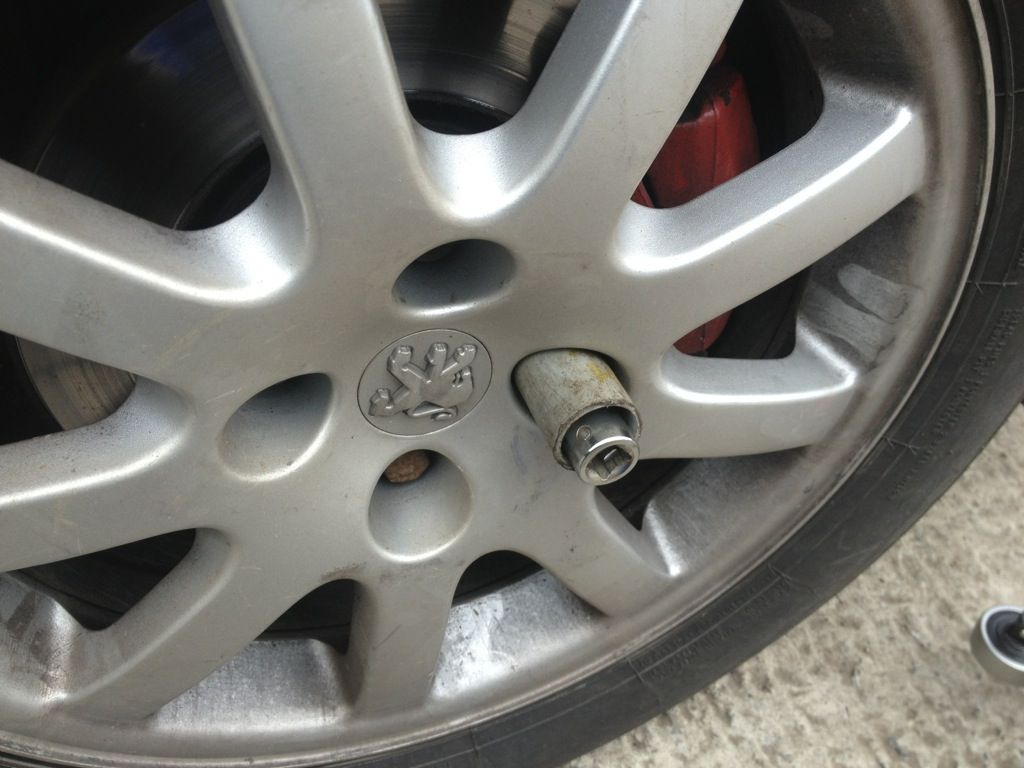

Ive started using a bit of plastic pipe over sockets when i go near the alloys to prevent them getting scratched, possibly OCD but after getting them refurbished i dont want to have any scratches:

Fair dos with the plastic pipe, if the paint wasn't baked on it'll be soft for a while.
