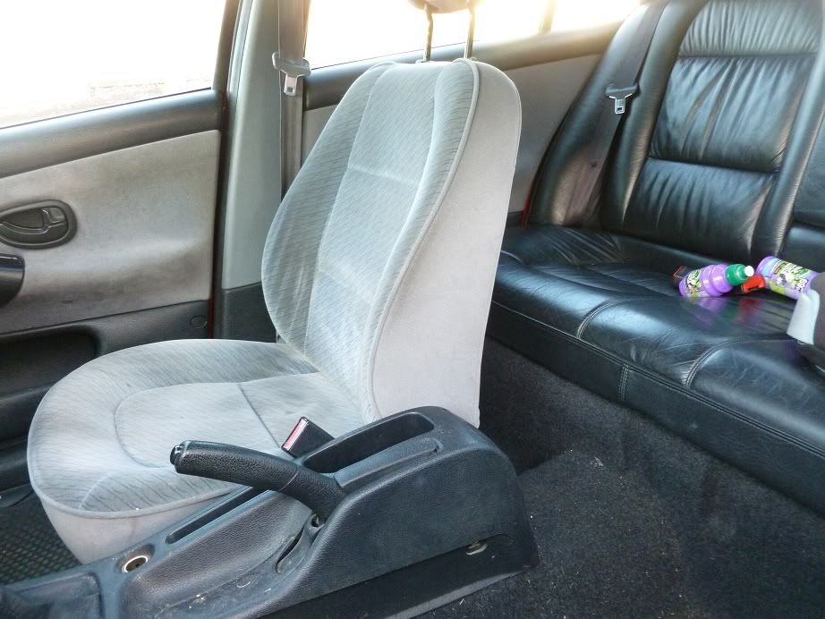

well been very busy today. my head is banging after doing all this in 4 hours ....
changed my front leathers over now and fixed the non existence airbag light. now thats working perfect

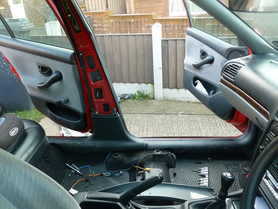

seats being removed

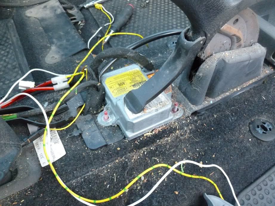

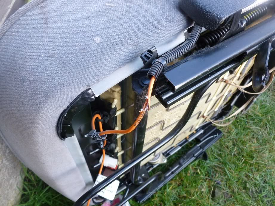

found this on the drivers seat . this is probably the reason the airbag control unit was knackered
anyway this wire has to be transfered to my leather seats because for some reason peugeot decided to change the plugs under the carpets on the car so transfering this wire meant i could plug in the seats to the car
i re-connected the wires by twisting them tight and wraping insulation tape round them . then fitted the orange wire to the leather seat

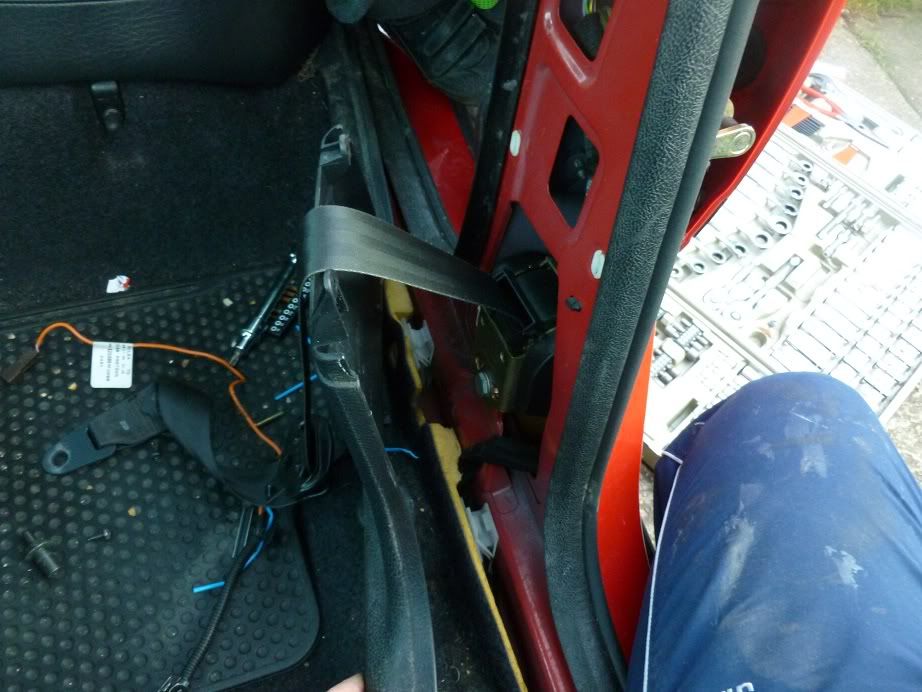

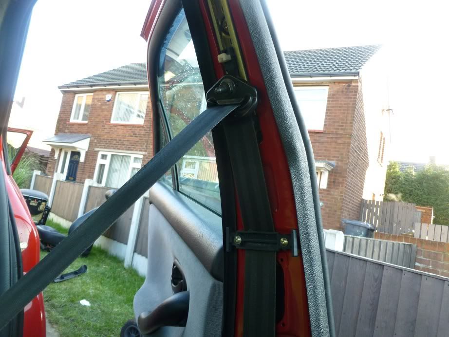

next was changing over the seatbelts. had my black belts that i got from farmerpug . grey belts on black leather dont look right so may as well change them while seats were out anyway

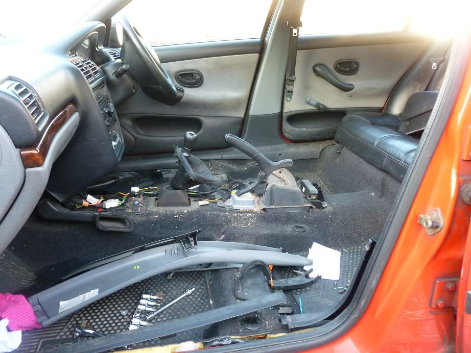

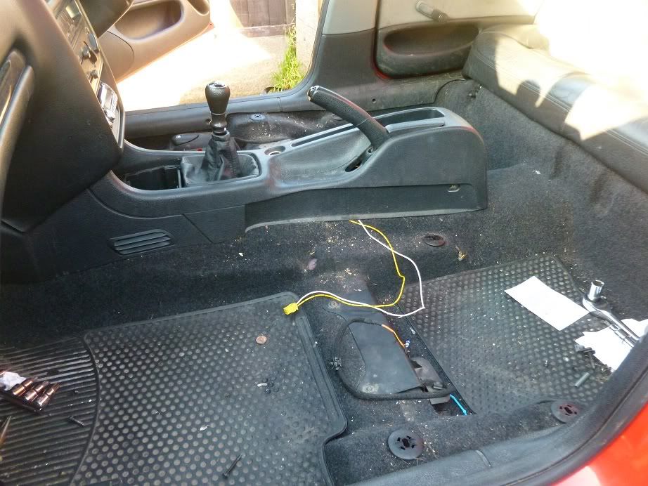

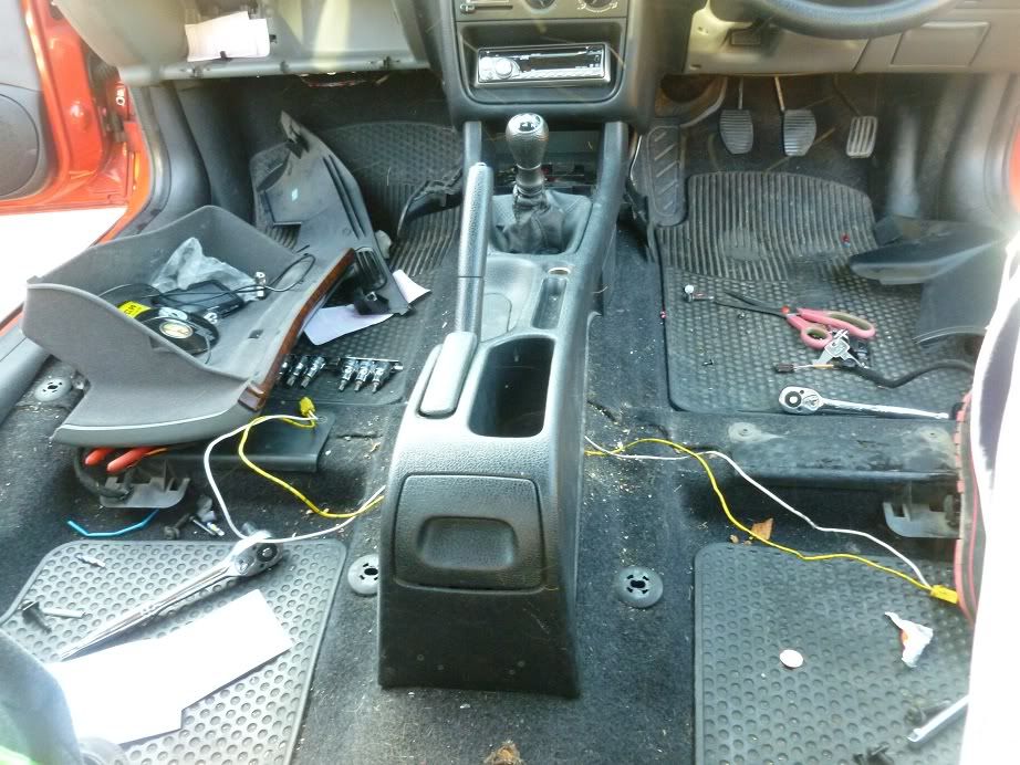

seats removed and center console ready to change over the airbag ecu and install the cables for power to leather seats

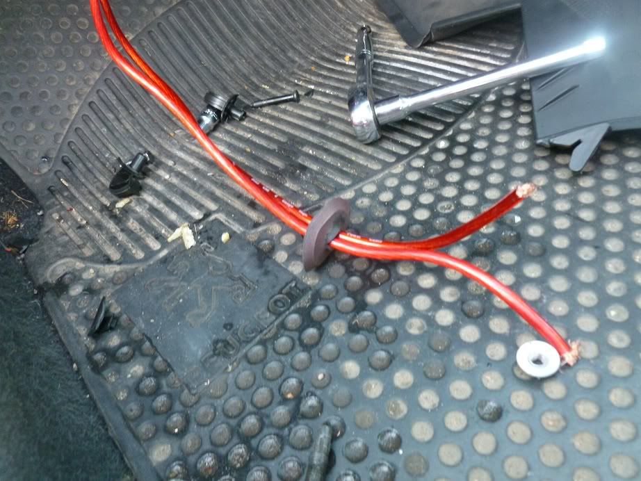

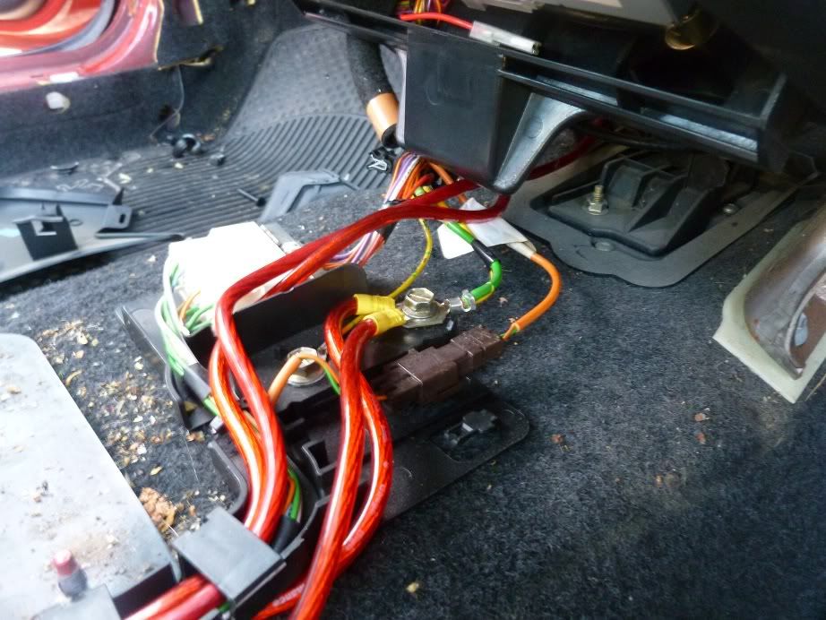

installing power cables for power to the electric seats. run my 2 cables through the access gromet behind the glovebox to battery
this is were i earth my electric leather seats too . under radio there is an earth point
and this is the cables all in position to power the electric seats

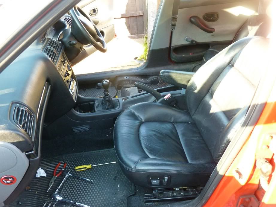

and finally. plug power into seats and the airbag wire and job coming to the end

Just out of curiosity, how come you used (what looks like?) 10mm² sized cable for the seats and then dropped down to something much smaller?
Not putting your work down, just being nosey :P
Also if you wanted to tidy up the cable you can get braided sleeving called a cable sock from maplins. You can get them in all sizes ;)
Re: My 2nd D8 1.9TD
cant see wires when its all installed sam . no need for tidy cable.. :mrgreen:
the lenth of the cable from the yellow plugs insnt long enough to reach to battery and this was standard from my glx seats when i got them. . so i just hooked up some 30 amp connector blocks then used some spare 8gauge amplifier cable i had to run it to batetry and earth.
thats why its thicker... i could of used speaker cable but had non spare so just used what i had at the time... it shouldnt be a problem so just left it like this
and near the battery in the red cable is 2 small fuse holders with small fuses in just in case ..
these are the fuse type holders i used
i used same size fuzes thats listed in haynes for electric seats
Re: My 2nd D8 1.9TD
and to be honest. the cable inside the red sleeve isnt much thicker anyway. the cable looks thick cos of the red sleeve but in fact insode its very thinish ...

Good job! Those new seats look great... definitely keeping a lookout for a set for my D8. Thanks for the pics mate :)
