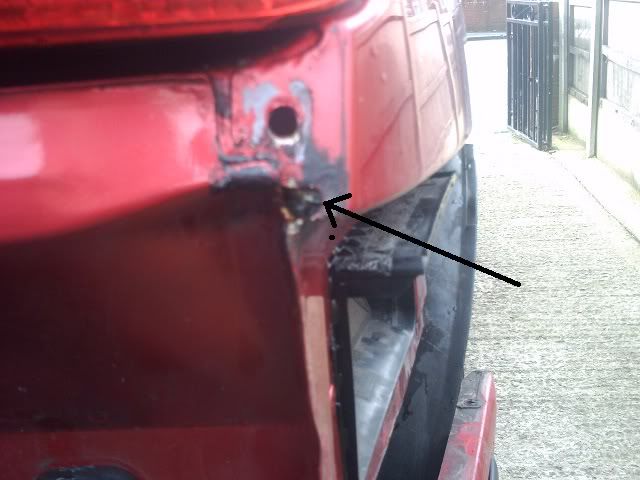

Re: Water in the boot - reloaded
were u see rust inside your car is coming from here. arrowed. best access is from outside. you can see were the 2 panels meet .
what i did was poke all the old seal out with a screwdriver so it left a big hole. hen refilled it with tigerseal. this stuff is the buisiness
removing the bumper is very easy mate if u need i can point you to all the bolts.
the light is obviously leaking with the crack. but the rust in the corner of the quater is not caused by the light leaking
i will put money on it being here
Thanks Gar, I only needed confirmation it was the same spot. I have the Haynes for the bumper so no problem about that.Gary406 wrote:were u see rust inside your car is coming from here. arrowed. best access is from outside. you can see were the 2 panels meet .
As soon as it gets sunny for a while I'll remove both the bumper and the light and fix the problem. I have a mate whose father is an electrician and hydraulic and he gave me some of what they use with rain gutters, it should be super strong.
I'm worried about the rust, that I won't be able to remove all of it.
