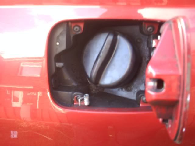

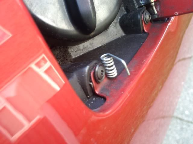

this is were i put my peg spring. easy get one of these springs from your washing line (dont let the wife see you tho)
this has worked for me for over 1 year now and opens the fuel filler lid perfecto
as you can see its just a case of loosening the torx screw and sliding the cloths peg spring into place and tightern it up. job done

Thanks, Gary, looks like a great idea. I suppose any spring steel with a mounting hole would do the job. I'll do it Saturday when I've got some free time. I'f I carpool I won't have to fill up till then (my carpool mate has a Toyota Corolla, he lets me drive it, not half as much fun as the 406).

I can confirm the peg spring fix works as I did mine when I bought the car 14 months ago and it opens every time

Re: Fuel tank door release
it wasnt my idea this mate . i got the idea from this forum when i joined up about 12 months ago.Battar wrote:Thanks, Gary, looks like a great idea. I suppose any spring steel with a mounting hole would do the job. I'll do it Saturday when I've got some free time. I'f I carpool I won't have to fill up till then (my carpool mate has a Toyota Corolla, he lets me drive it, not half as much fun as the 406).
great idea whoever thought of it cos i would have never thought this 1 up
