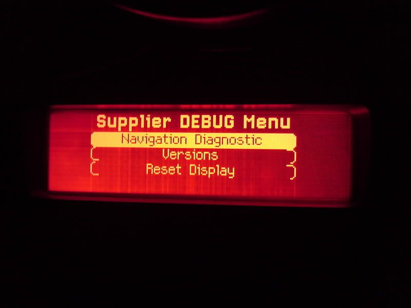

bra1nDeaD wrote:I am also looking for some information about hidden menu's. I've read somewhere on a french forum (with pictures) about a hidden 'debug' menu where you could see GPS/ODO/GYRO configuration. I have the link at home (I'm at work now) so I will post that later. My french is not that great so I used a website translator and this is (I think) what it said:
- press 'menu'
- long press 'esc'
- press 'left' twice
- long press 'esc'
But it does not seem to do anything :shock:

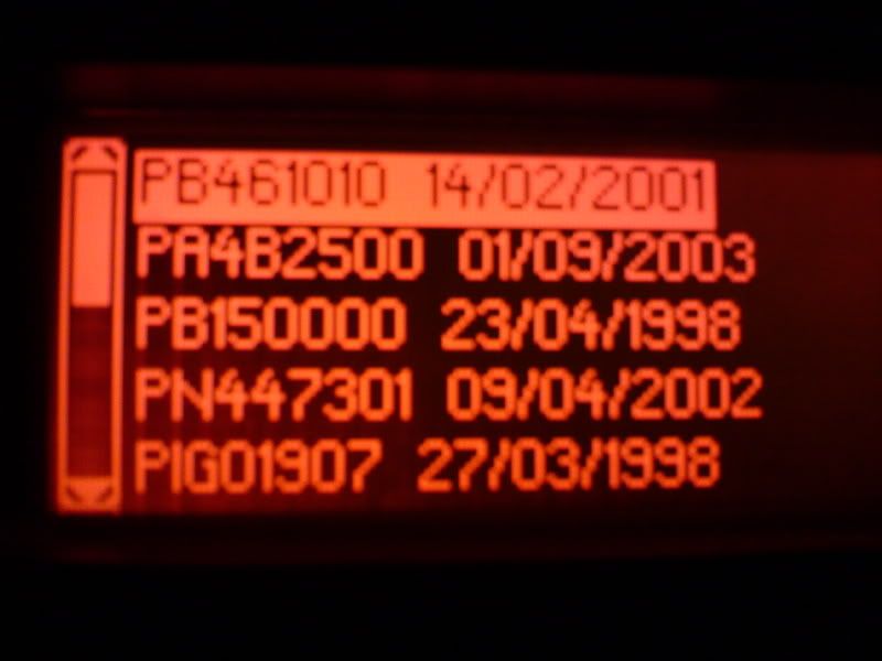

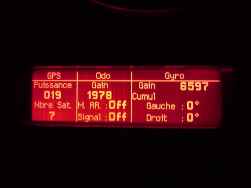

Well well, look at this....
"Navigation Diagnostic" brings up this...
...and "Versions" brings up this, no idea what they mean though :oops:
"Reset Display" just takes you back out.
Very interesting, makes me wonder what other hidden menus there are.... :?

bra1nDeaD wrote:Did you get this with the key combinations that I wrote here? Because they dont work on my car :(
Yup, exactly what you wrote, the "long press esc" you need to hold for a good 5 secs. Also I did it with the ignition on but without the engine running, don't know if that makes any difference.
The "ODO" bit is all about the sat nav I think, can't see you being ably to adjust the car's main odometer from there... :? :?

DaiRees wrote:The "ODO" bit is all about the sat nav I think, can't see you being ably to adjust the car's main odometer from there... :? :?
It'd make sense that it hooks up to the odometer for speed data. Combined with a form of gyroscopic sensor it would allow the car to make a damn good guess at where you are when you can't see any satellites (in a tunnel, surrounded by large buildings, etc)
