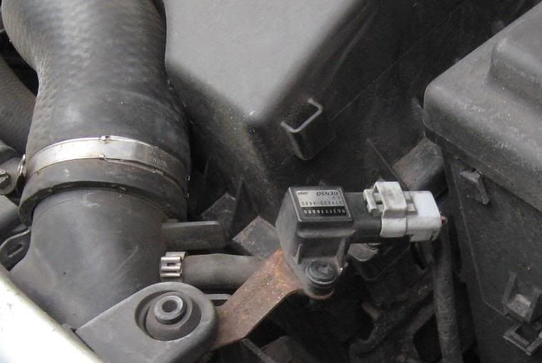

Sounds like it may not be regulating the turbo pressure correctly. The ecu measures boost pressure via the MAP sensor, pictured below:
(This is from my car, but I think a 110 is similar). This is in a vulnerable position and is worth examining for leaks etc.
Pressure is controlled by operation of one of the 3 solenoid valves on the bulkhead - (which work the egr, high pressure regulator and turbo pressure valve - this is the one of interest). These are electrical valves, which switch the vacuum flow to the actuators themselves - I dont know what the turbo boost control actuator looks like, but it is turned on/off rapidly via the solenoid valve to regulate boost pressure.
