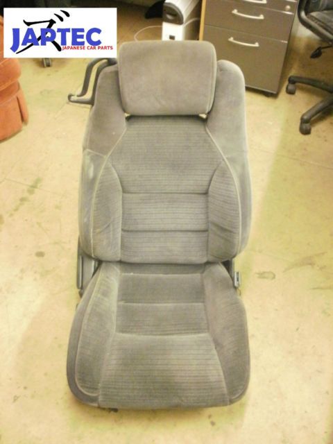

What do your replacement seats look like?
Re: hello newbie here:-)
New seats look like this
All the adjustment for tilt and slide is manual and the lumbar and side support (sides move in and out to hug you) is switch operated, obviously if I have to use the Pug seat rails that will have to be electric also so I'd rather use the supra one to keep things simple... I'll have to wait and see once I have bought them and took the old seats out. I might get some older Pug seats though yet, Ill nip up to my local scrappie and see if he has any in but I could do with knowing if the lumbar adjustment will work in my car?

Melody wrote:New seats look like this
Please don't try to fit those into your 406, you will bring much shame upon us, we will have to shut down the Forum until further notice
Haha ok I won't fit them! But they are the comfiest things I have ever sat in, well, mine had blue leather but stillWelly wrote:Melody wrote:New seats look like this
A sea of crushed-velour 1980's Nissan Bluebirdiness and thousands of sweaty-arsed car journeys later..........
