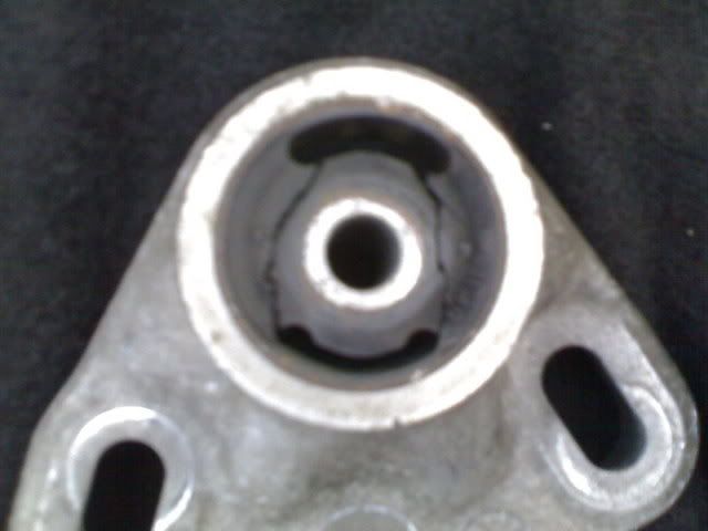

jameslxdt wrote:i had the same issue and changed the wrong mounting
this is the bugger that causes the vibration
Yeah my one of those is bad too, but last time I looked wasn't quite as bad as that one.
Part #183946 £27.95 inc vat according to the servicebox website. I was expecting it to be more expensive than that. Think I'll be on the blower to the stealers first thing in the morning!
It just took 22 minutes to replace the mount in your pic, including a few talking to colleagues (did it in the car park during lunch break). Not bad eh?
It's made a noticeable difference to how the car drives, but so did the last part of the mount I replaced. Only time will tell if it's the other bit I guess...
