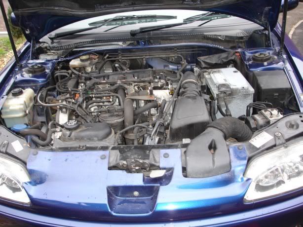

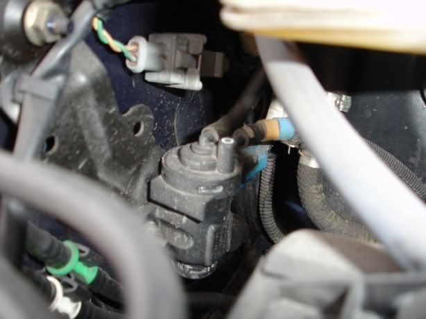

www.pug306.net wrote:ok ill keep this short! take one hdi engine bay!
If you look at the top left corner the EGR valve is placed just out of sight...
it looks like this
you can see the blue clip at the back. this is the part you need to remove... i used a screw drive to press back against the egr valve on the blue clip and it just pops off. like so
For me, it frees up the revs and will hopefully improve mpg!
instead of taking the plug off, take the vacuum pipes as i said, as im sure it will put the K light on

Many Thanks james will give it a go tommorrow. The valves are on the baulkhead.
Just out of interest how is the flow meter connected to the egr valve. Does this mean that the probable cause of all this is the egr valve is shot?
Thanks again. Your advice is very usefull.
Oh and when you say block of the pipes i take it you mean the actual pipes and not the solenoid connections?
