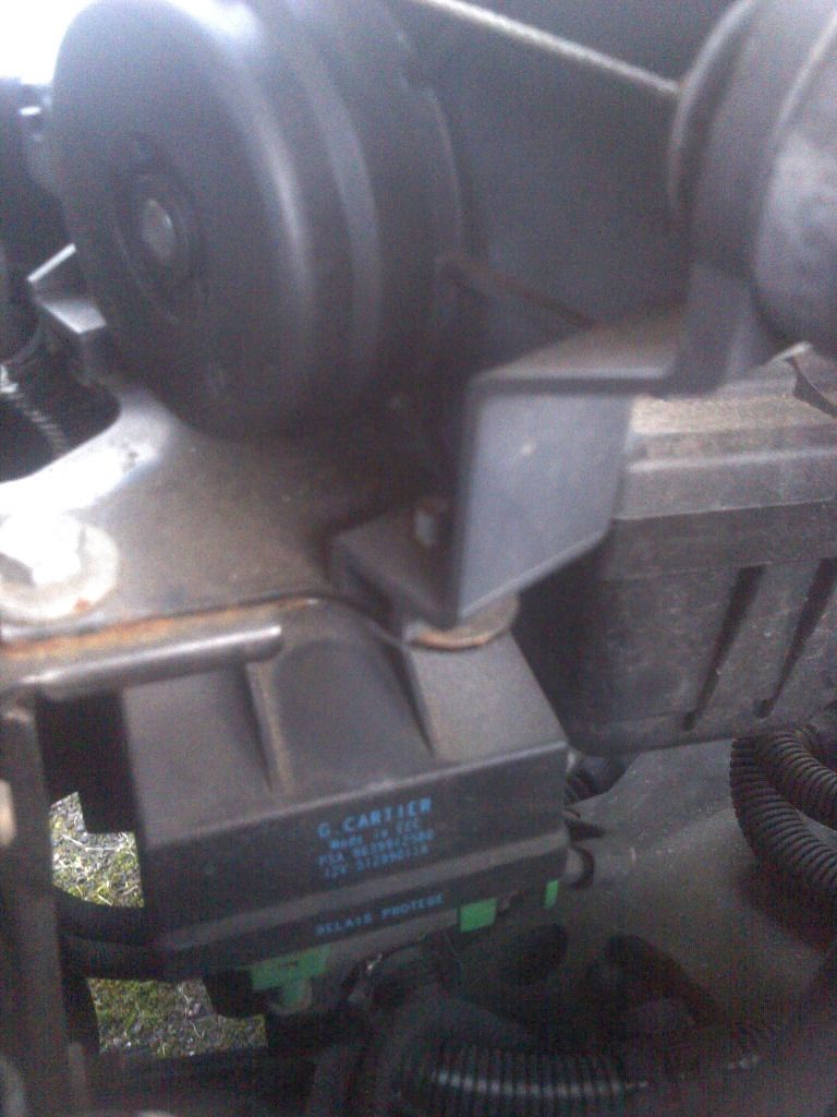

I was under the bonnet earlier with the engine running, when I thought I saw a whisp of smoke come up near the throttle link :shock:
as I had a closer look I caught a wiff of that horrible hot electric smell... you know the kind thats not good.

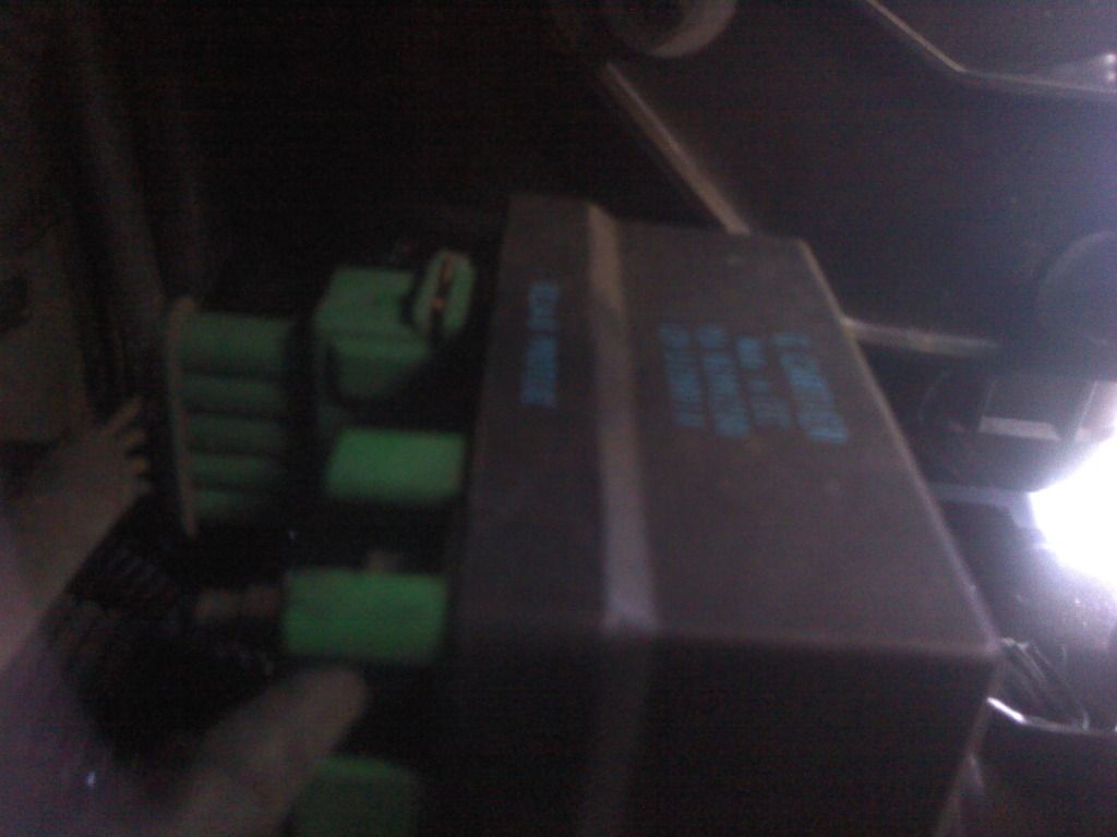

I spotted this under the throttle behind the airbox, the box with the green connectors... the top of it felt warm so I ran my finger underneath... Ouch thats friggin hot :evil: it shouldn't be that hot... thing is its now cool to touch with the engine running

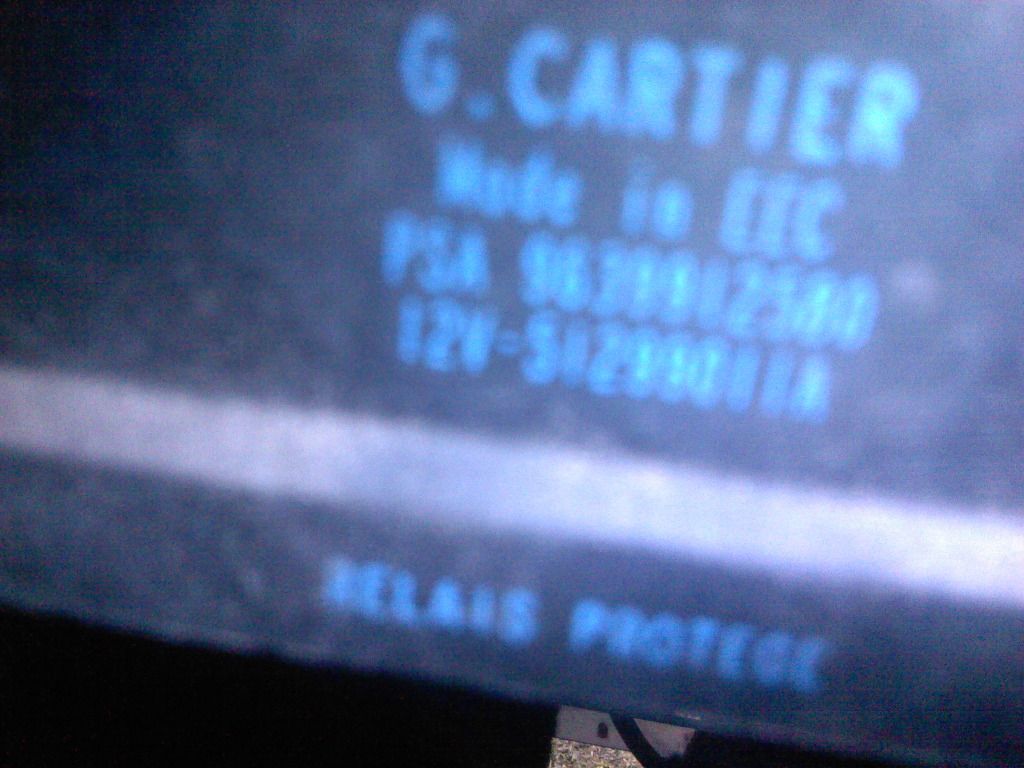

Its a relay of some sort I think but for what :?:
sorry about the last pic being blurry.
Any chance it could be linked to my cutting out problem?
or is it more like just something else that needs sorting :roll:

My guess is Glow plug (pre-heat) Relay,

Yes it's the Glow Plug relay

Thanks, prob have to change that as I dont think smoke shouild be coming of it :lol:
Re: What is this???
That doesn't sound right no :?
There's two sorts depending on whether the car's EOBD or not, the changeover is in about 2003 (depending on engine, it's 12 July 2003 for the 90)

Its a 2001 2.0l Hdi 90...
Seems to be one thing after another with it at the moment :(
Re: What is this???
Ah, I found yours was a 90 but I wasn't sure of the year. There's a hell of a lot of current running through it, so I guess if the contacts aren't 100% and have a tiny amount of resistance to them then it'll get rather warm. On the same note, the connectors to it need to be spot on as well, so perhaps worth checking before you do anything else.

Thanks :)
I'll have a go at that first...
