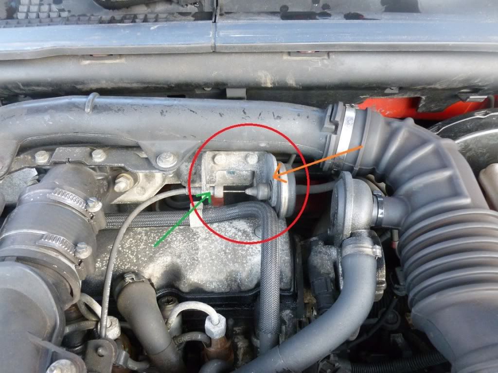

hi new here i have a 406 1.9td she runs well but seems a little slow on pulling away i here most people talking about the egr valve and blanking this of where is this on the car. also what should the tick over be she is running about 1100rpm if this is to high how do i turn it down.

when you say slow ? how slow actually ? they are a generally slow engine really.
the 1100 rpm tickover will be the cold start sticking on. ive only found one way to fix this and it works fine. did it on both my 1.9td and even in cold it still starts 1st time everytime
below is a diagram of the cold start mechanism. it must stick with age because every 1.9 i come across has this issue
anyway the bracket arrowed ORANGE needs to be bent to the right a little. get a hammer and hit it to the right you can see how i bent mine.
dont worry u wont break it . it bends very very easy. only a light tap with a hammer is needed
once you done that simply screw the bolt arrowed GREEN in. undo the little nut holding it into place its 14mm then screw that nut to the top of the bolt .
then screw the bolt in (clockwize) once you have got your right tickover RPM screw the 14mm nut back down to lock it in place
do all this while the engine is running. when you screw that bolt in you will hear the engine drop revs to 800rpm
Re: 406 1.9td 1998
i set my RPM to 900RPM i find it better here than 800RPM . for moving off in 1st gear no revs is needed to set off at 900rpm.
if you set it to 800rpm revs are needed to set off in 1st gear.

"Below is a diagram of the cold start mechanism. it must stick with age because every 1.9 i come across has this issue. Anyway the bracket arrowed ORANGE needs to be bent to the right a little . . . " (Gary406)
Is the black tubing shown to the right of the bracket (just below the orange arrow) supposed to join onto anything? In my 1997 car (otherwise identical to Gary's image), this bit of hose is a mere stump, about a centimetre long and stopping short in mid-air. Has somebody been bodging? ('Please, sir, it wasn't me!') If so, where does the other end of this hose go?
I have not had any problems in starting or running.
Oliver Mundy.
"Don't rush ahead when you can't see ahead. Ahead is the place collisions come from." (De Dion owner's manual, 1913)
Re: 406 1.9td 1998
on mine it joins to a T peice thing that seems to go nowere on that side. but the other side were the cable runs goes to the back of the fuel pump (cold start valve)

I have attached an image of the part of my engine compartment roughly corresponding to that shown in Gary's picture. (Mine is a good deal grubbier, but what can you expect in a car bought for £355?*) It shows how the bit of tubing to the right of the diaphragm-chamber (I suppose that is what the round thing is) stops short, whereas in Gary's car it goes on, apparently heading towards the nearside suspension pillar. The Haynes book on the 1997-9 cars (page 4B.5) describes it as a vacuum hose and says that it should be disconnected before adjusting the fast-idle, but fails to explain where its other end is. I suppose the vacuum-pump on the end of the cylinder-head (just below and a little to the right in the pictures) would be the obvious place, but there does not seem to be any unoccupied connection-point on this.
