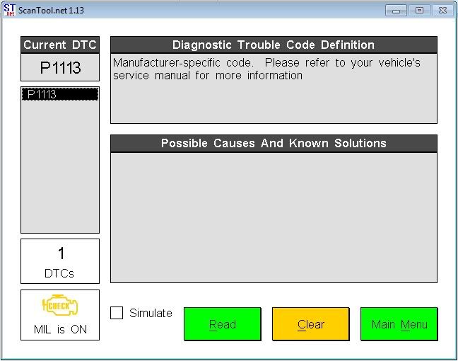

So I was on the way home yesterday, joined a dual carriageway and pulled out to pass a bus, accelerating up towards 70 and I had a sudden loss of power, Antipollution Fault :roll: and Engine Management Light :cry: :cry: :cry: :cry: :cry:
I was right by a junction so pulled straight off the dual carriageway and found a spot to park up and take stock, turns out she's in limp mode and limited to 2000 rpm, running rough below that too if there's any load on the engine. So I limped it the 15 miles home (2000rpm = about 47mph in 5th BTW, that was fun! :oops: )
Read the codes:
Brilliant, I love it when the code doesn't tell you what the fault is :roll:
Reset the code and the car starts without the fault, but as soon as you rev it up the fault comes back.
http://www.bba-reman.com/content.aspx?c ... d_metering says
bba-reman wrote:P1113 Intake air temperature (IAT) sensor circuit open/short
Any idea where that sensor is? Or any other ideas??
HELP!

Oh lordy :( The stuff of nightmares, especially on your lump. Umm, looks like it's on the throttle body, according to Service Box (19208Y)
Oh, only 33 quid :frown: Seems common to a hell of a lot of cars and there are cheaper about - http://www.ignitioncarparts.co.uk/PartL ... lue=19208Y
Oh yes, a hell of a lot of cars :shock: http://www.ignitioncarparts.co.uk/PartD ... 005&s_vid=
Worth changing it for 9 quid, I reckon.

Can't do any harm to undo the connector and slide it it back in a few times, look for anything displaced on the air intake pipes etc.

Right, I'm in need of a sanity check here...
I've got the sensor off and given it a clean, checked the connections etc, started the car, no difference.
Then I started the car without the sensor connected, still no difference.
To my mind that means that the sensor's deffo knackered... or am I being overly optomistic?

Sounds like it's open-circuit to me, Dai.
Re: HPi Antipolution Fault, P1113 & Limp home mode - HELP!
I would agree with doggy Dai , given that list of cars that share the same
sensor do you know anyone with a car thats on that list , quick swap to be
100% sure ???

Well got the sensor (only cost me a tenner in the end) but it hasn't cured it. :evil: :cry:
I see several references on the net to people taking HDis in to the dealer and being told it's fuel rail pressure, but I can't see how they arrive at that from this fault code.
Local expert is 40 miles away (at 2000 rpm!!) and can't look at it until Thursday...
Anyone able to offer any more guidance?

IAP .... Intake air pressure fault , possibly MAF or MAF sensor problem ???
Oh bugger, one of those times the fault code isn't the actual problem, rather an indicator that you need experience to interpret correctly. Or a forked stick...
Perhaps the problem's at the other end of the cable - try reseating the ecu connector :(

So I got it to the garage at no more than 2000rpm, avoiding motorways and dual carriageways and using all the "old" roads (that was fun, particularly the really steep hill start with a lorry up my chuff!! :frown: :shock: ). Anyway, the feedback is that as suspected it's a fuel rail pressure fault, the LP pump is fine and performing to spec, so it's either the HP pump, rail or regulator. He's ruled out the rail so we're looking at replacing the regulator and / or the pump. Both together come to around £500 + fitting + VAT :cry: . To be fair he's suggested that he changes the regulator first 'cos it's the much cheaper part and if that doesn't solve it he'll change the pump. I have a sneaking suspicion that it's going to be the pump at fault though, and a failed pump causes the regulator to fail so both will need changing anyway, I fear this is going to sting bad!!! :cry: :cry: :cry: :cry:
