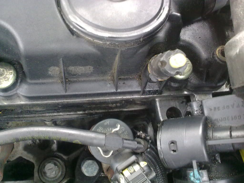

Gah, there's still an oil leak around that area somewhere. Little puddles developing again after a few thousand miles... Can't see where the *%&^ it could be coming from.. Grrr...
Going to clean it all up and see if I'll be able to trace it that way. Any other seals around that area that could be knackered? Seems to be coming from the edge of the head cover (the thing that sits between the rocker cover and and the crank case) but I really can't be sure.
Any other ideas?
Any other ideas?

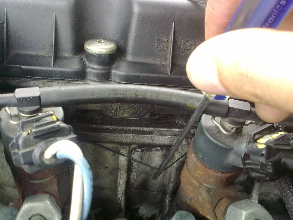

What is this rubber bit and why is it just hanging loose? It goes around the block
Could it be coming from betweek the injector seal?
The leak is quite small, i.e. it take a couple of thousand motorway miles before I see some evidence of it.
Also, while cleaning around there, I detached the intercooler hose and found that the insides had very noticeable traces of oil... is that normal?
Re: Oil leak?
The rubber piece is part of the gasket for the camshaft block, ie, there are three parts: Cylinder head, camshaft block, and rocker cover (camcover).If you look again, you will see the gasket bulging out in a curve.
There is a gasket between each unit.
It will mean removing the camshaft and the block to replace the gasket, if you don't want the hassle or the cost, smear some silicon sealant around the camshaft block, this should seal it given that it's a tiny leak.Ideally, you should replace the gasket.
Oil in the intercooler pipe is normal.

How annoying! The leak is STILL there. Both gaskets have now been done, including the vaccuum pump oil seals and the oil is still accumulating in that area!
The only thing I can think of now is that it's the injector seal that perished, causing the leak. I am still losing oil slowly and need to fill up every 5-6k miles.
Could this be an injector seal and is it easy to replace with DIY?
