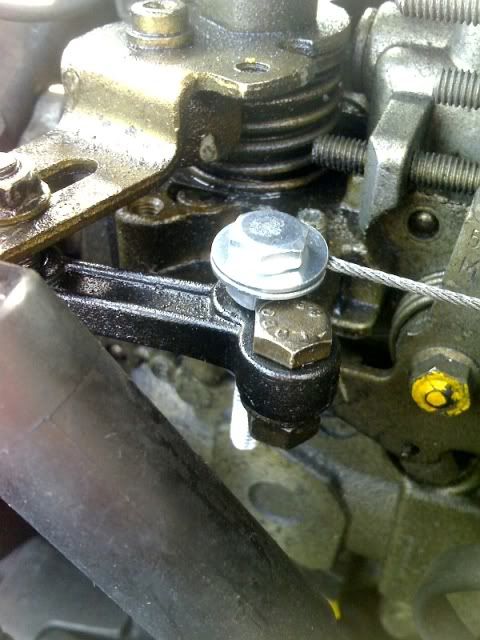

Check my mad bodging skillZ
The man with no car
Re: 1.9 idle adjustment
It's bodgetastic!
