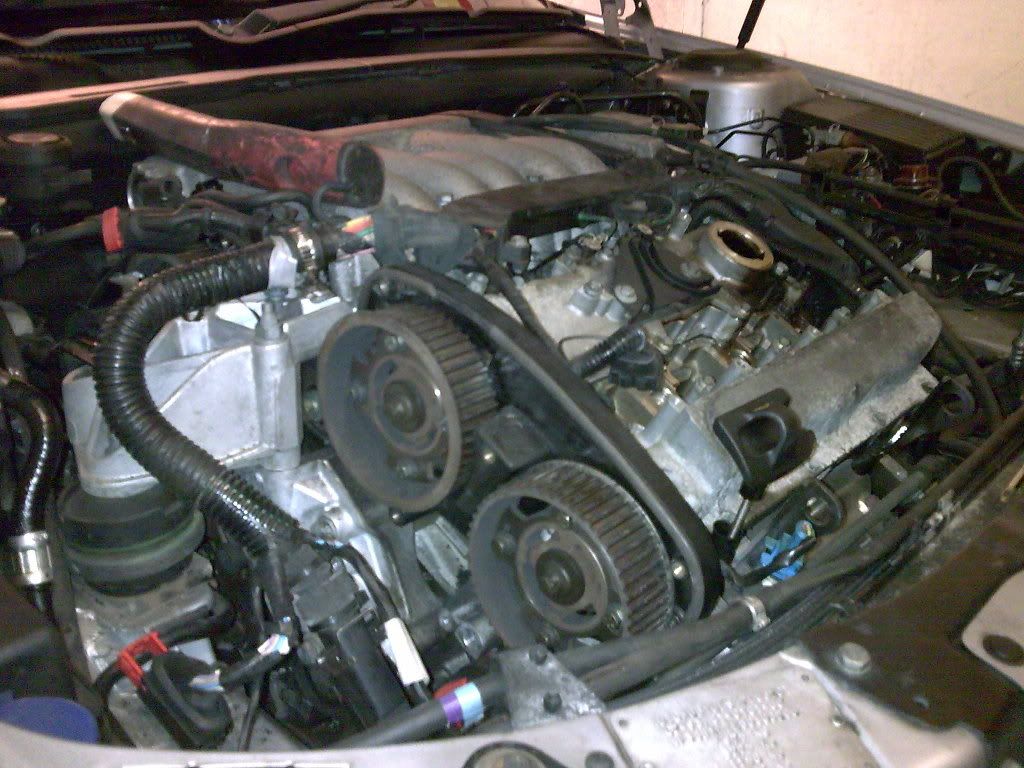

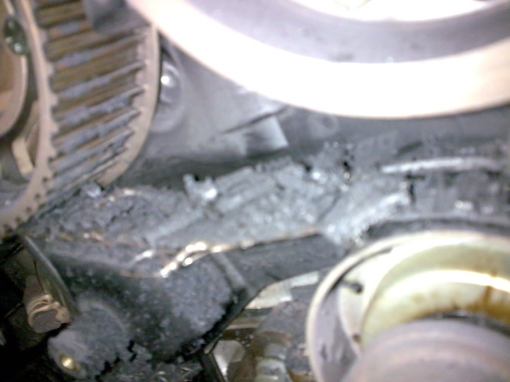

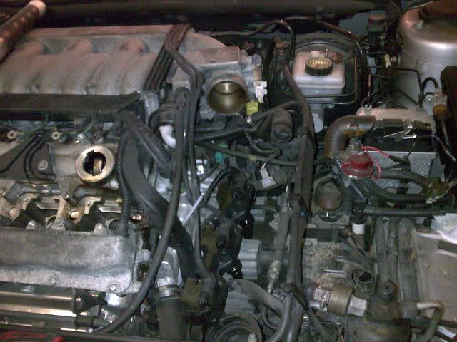

hi all gonna upload some pics of the on going work on my v6 not got to far the engine is like a maze lol

Re: v6 engine problem
Got any decent sized pictures of the engine out of the car? Always handy to see these things from different perspectives...

lol i will try upload again bigger this time give me a min
