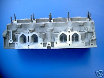

from what i have heard the valves are smaller on the 205 1.9 gti head. also the inlet port are shaped differently
205 head inlet ports
sri head inlet ports
