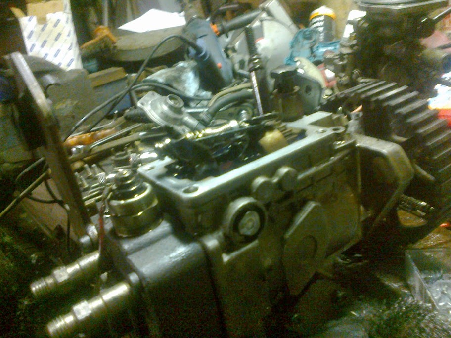

Decided to pull my finger out of my ar.... mchair and get this pump built :cheesy:
First: Convenient DXH on a pallet
11mm bolt missing.... :?:
Puller needed
These Polo driveshaft bolts are the right size, length and have collar for locking the sprockets. Stronger too
Slack...
That was a pig to take off.... Thankfully I didn't lose the woodruff key!
Prep for removal
Off! Tamperproof, boooooo-earns :evil:
Yeah right :P

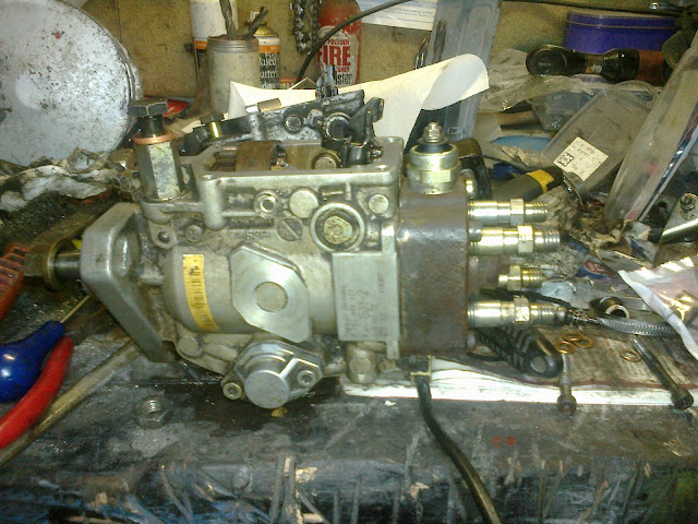

I've removed the throttle assembly, max rpm and idle screw to access the 4 top bolts properly
The 414 vs the 494. The 414 has much cleaner internals
Gov assembly's compared
The mutant result
Next: the head

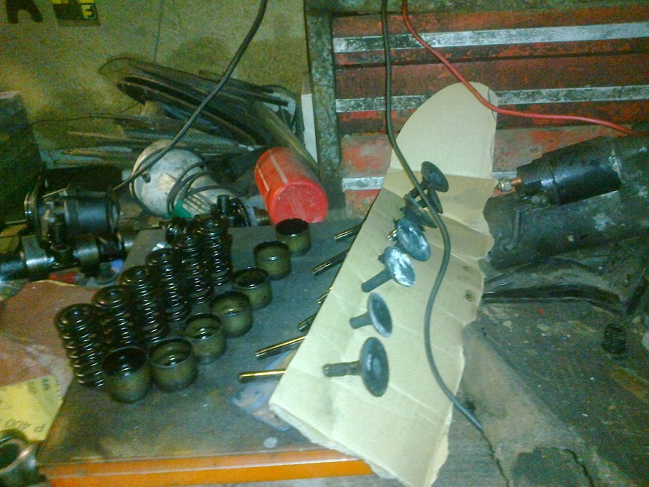

The head off
The 11mm plunger vs the 9mm!
And distributor heads
All this effort for those bits :oops:
I decided to install it this way
New O ring
All ready to tighten down
Distributor valves
Somewhat finished... The bottom half is anyway
New top seal
Throttle shaft seal
A fiddly job...
I set my pump from full throttle :cheesy:
Finished!

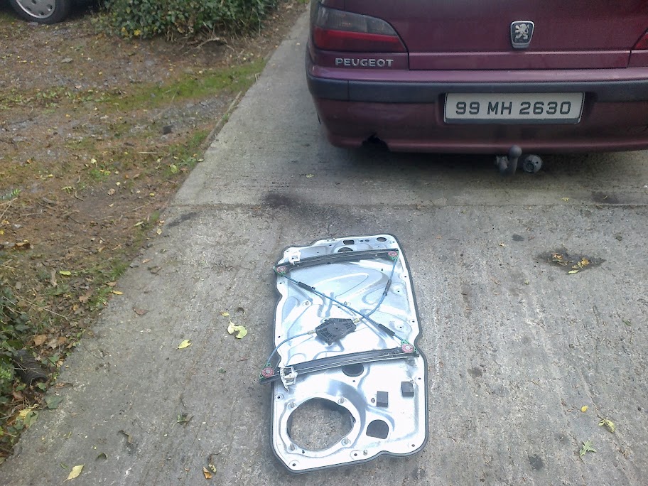

After I cleaned the car, I cleaned the glass
Then broke out some polish
Halfway there...
Mirror :shock:

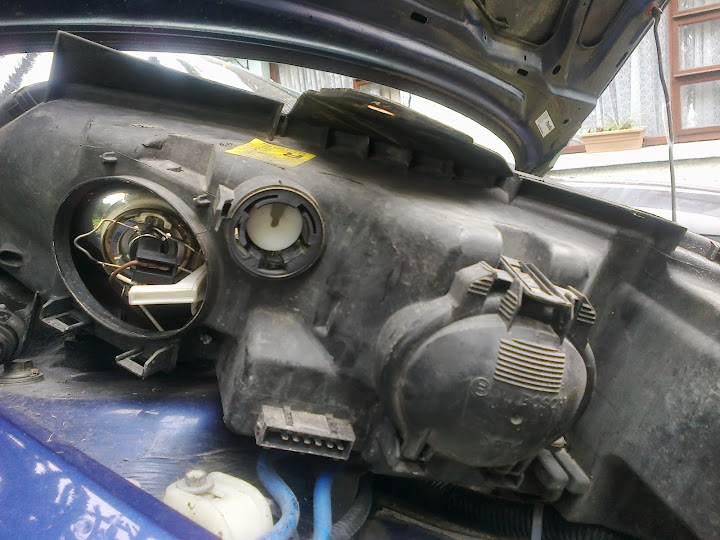

For the crack I tried the projector lights.... Thoughts?

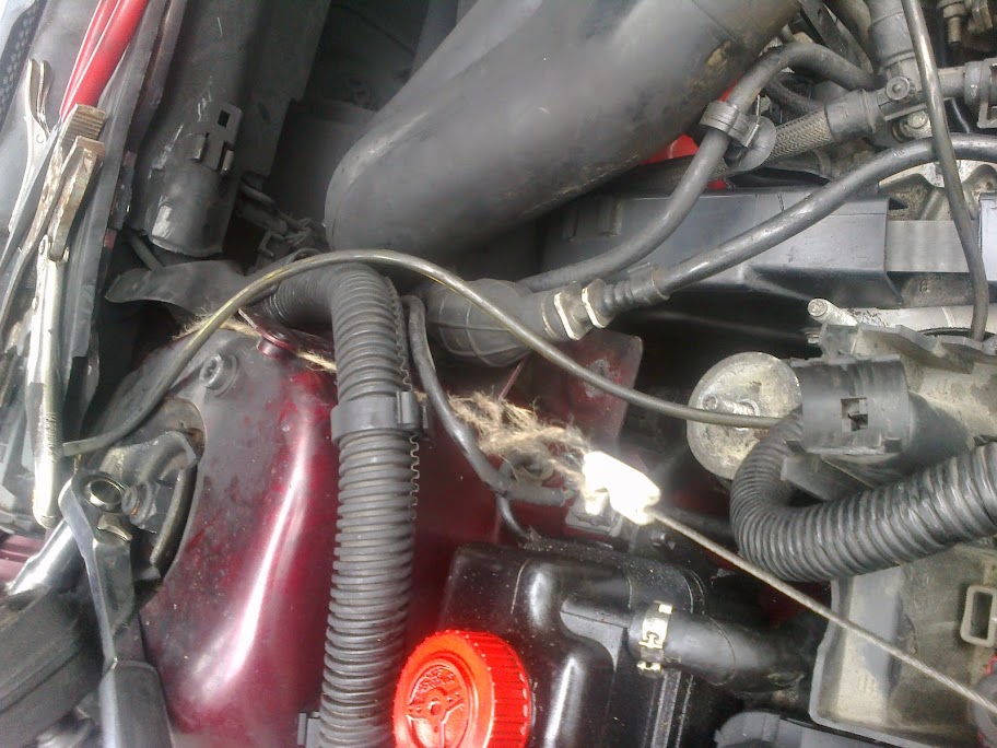

When all that was done I went for a test drive. All grand until no power atall :?: It was creating a vacuum!!!!
Must be the pipes.... No, all clean.
Must be the cooler
No, it's fine
Must be the wastegate, so I sealed it shut
No. I was going out of my brain :cry:
Then I tried it without a filter..... Success!!!! :cheesy: It's got the bin since :P

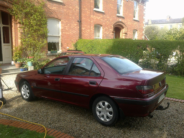

As of the 5th of Jan, I'll have this car a year :cheesy:
Since the K14-2 swap, this car is an EPIC daily driver. Very few can outpace it, as a young fella in a WRX found out one night at the lights :cheesy: :cheesy: :cheesy:
Not much has changed, although the car is in a sorry state at the moment :( more on that later...
Apart from that, what have I been up to? Enjoying my car 8) and enjoying the way it goes!!! :cheesy:

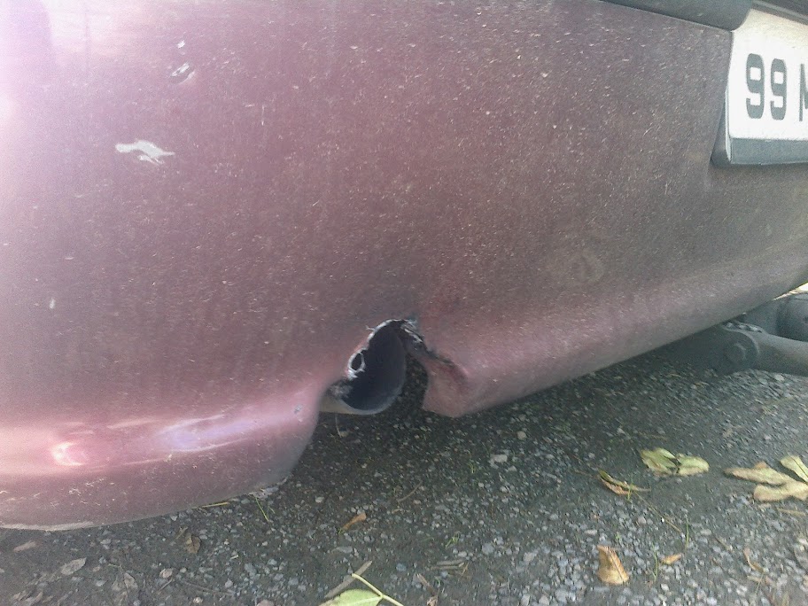

Small exhaust issue....
Only a small issue....
Mock up for correct length
Back on the road again :D Time to enjoy the car 8)

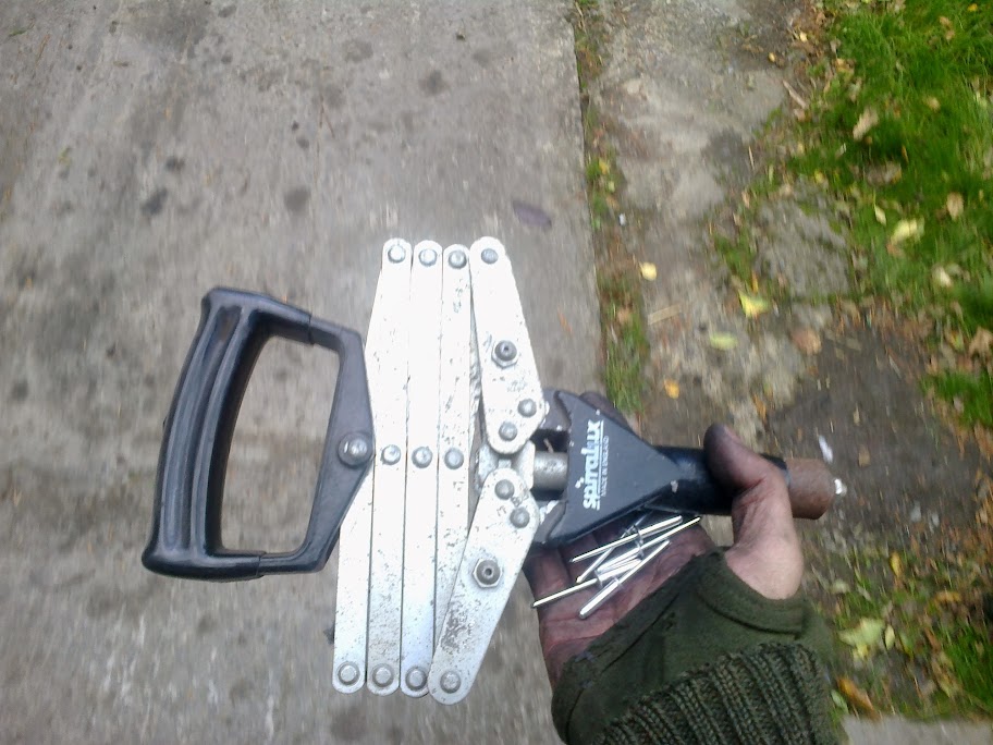

Rivet the piece from earlier on...
And now we have a handy way of covering up a mess that would have needed a new bumper otherwise :cheesy:

To my inventory, out with a spare head..... No make that a full engine! Head for now :D
Now let the porting madness begin...

Pump off
On with the hybrid pump, static advanced
