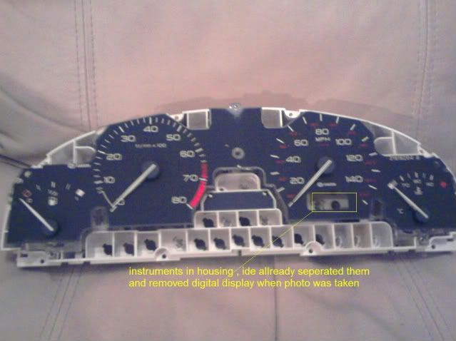

remove all the screws that hold the white backing plastic to the black front , seperate the 2 halves of the clocks .

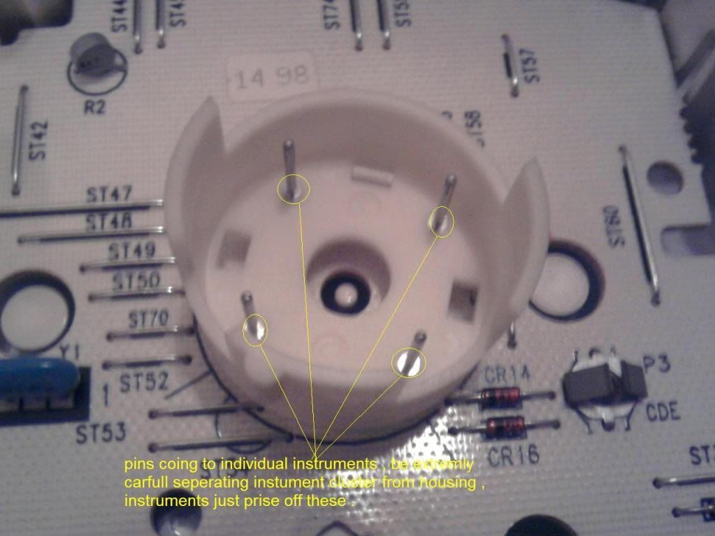

the actual clock faces temp fuel ect pull out with a bit of a wriggle ( take care ) as there are push fitting pins on the rear of each instrument connecting it to the pcb , these are like needles sliding indo holes so be gentle .

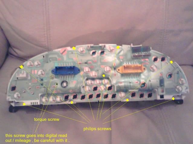

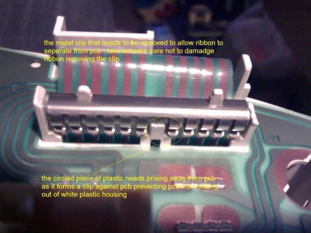

there is a metal clip that holds the wire ribbon needs removing , there is 1 torque screw holding the pcb the screw is next to the blue block connection that wiring harness goes to this screw appears to be the main earth connection between the pcb and the acetate pcb that bulbs are screwed into .

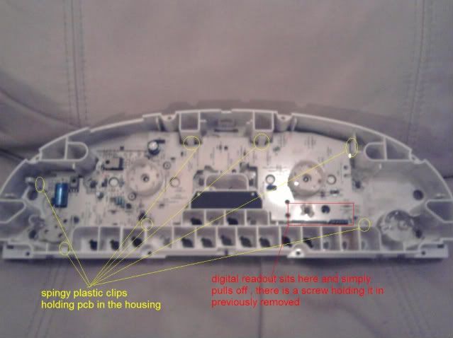

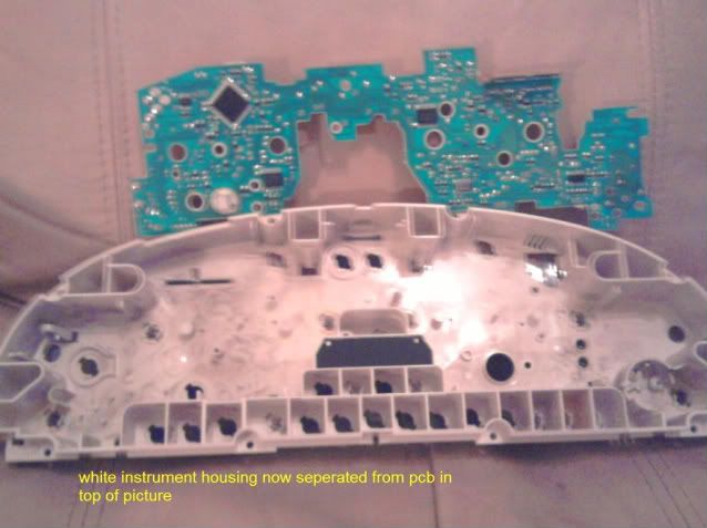

by this stage your inside the white plastic housing that encases the main pcb , if you look carfully around the edge of the pcb where it meets the white plastic housing there are several places where there are white plastic sprung bits that hold the pcb in place .
ive now got the pcb in hand and the only apparent dry joints appear to be the pins that push into the instruments , everything else on the board is much to fine to go near with soldering iron as there are micro resistors and components that are as amall as a match head , heres hoping anyway .
