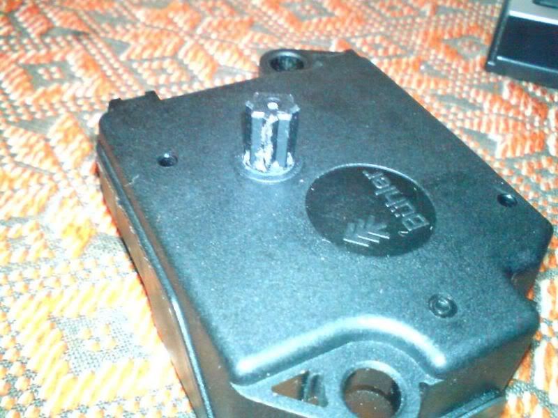

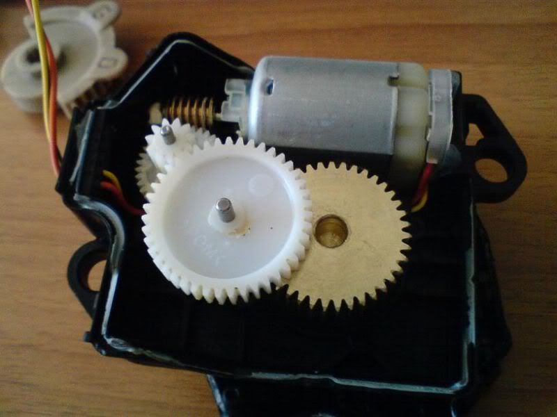

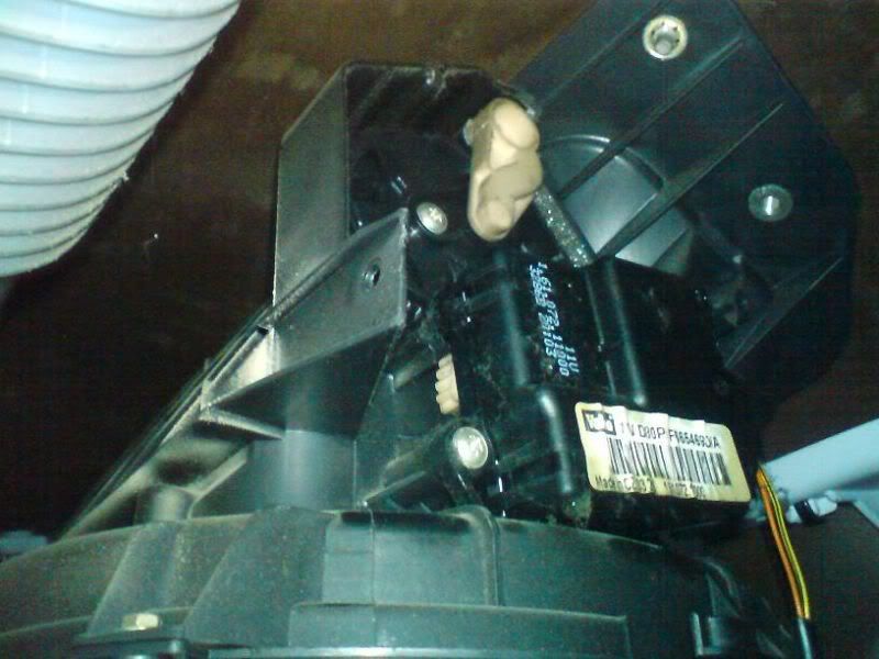

Ahh this is a common problem on 406-s. The button controls an electric reductor. It has a tiny motor and many little sprockets. The motor looks like one you would expect to find in a toy car. This reductor controls the outside/inside air valve and often brakes up. The bad thing is, that this little thingy costs a fortune! It is under the glovebox. Will post some pics later. And a possible solution :)
This is the reductor:
Here is the inside of the reductor. Usually the original plastic (modified with brass) wheel wares down and the anoying noise begins while the motor tries to open or close the inside/outside air valve all the time.

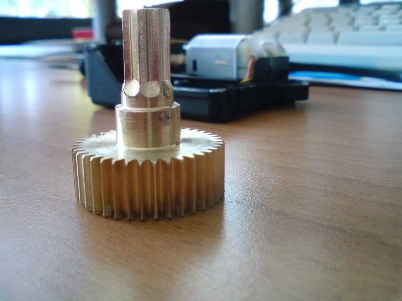

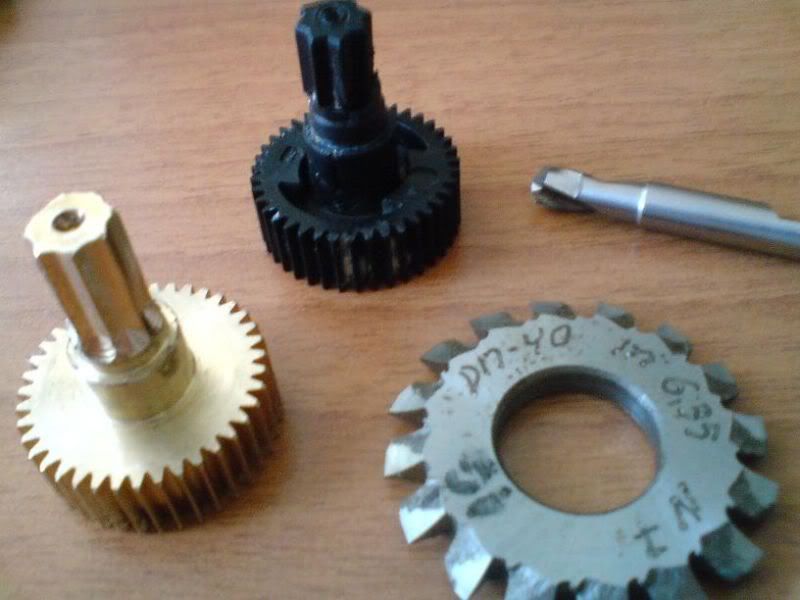

This is the new wheel that has to be made somewhere. Since i am not in england that is up to you...
Instruments neded:

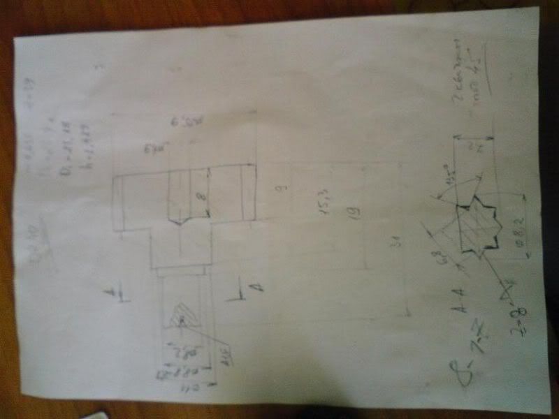

And dimentions:

Actually, the reductor isn't mine. It's on a mate's car in the bulgarian peugeot forum. He managed to make one at work, but he works in a big mechanical factory. He says the guys that made it aren't too keen on making more :lol: obviously it wasn't easy.
