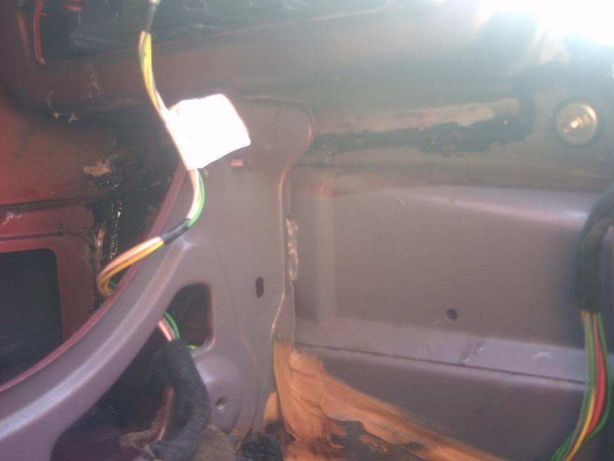

well found out were water is getting in again,
under the back window in the corners were the boot seal runs is a weld joint were 2 metal bits meet, water is running thro the weld :shock:
just pointing it out for any1 that may have water problem in car

having cleaned all the spare well out fresh water is in there now again,
i think its still getting in the thro the drivers side cluster light /// since i sealed it the light insode still remains wet and full of condensation,
so i will replace it and report back lol

Post by Gary406 » Mon Nov 08, 2010 4:57 pm
i know im probably boring you all now with this water leak but i really have found were its coming in :lol:
inside the boot under the light cluster is 2 bolts that hold the top of the bumper on right in the corner is sum "flexible Body Sealant" gone hard water is running like a river in here were the bumper bolt comes into the boot :x
hopefully my new light will arrive 2moro and i can finally sort this feckin water leak out
any1 ever had water leaking here ?

Post by Gary406 » Mon Nov 15, 2010 12:58 pm
hello steve (for knowledge basement), heres the pics of my gremlin, this is located under the drivers side rear light in the rear quater.
tiger seal is what i used this stuff is fantastic and it can even be painted if its an area that can be seen , this is the first cote , will apply another coat once that has dried.
cost £8.80 for the tigerseal and i would advise strongly to buy this before silicone sealant as i did it with silicone first and with the coldness of the metal body the silicone doesnt stick for very long and started letting water in after only 3 days. so pay for the best and get tigerseal
the black in this pic is the new seal , i removed all the old it had gone hard and was leaking water in, the big hole on the quater is were the vent goes, i will put it back in place once the tiger seal has set
and this one you can just see were it runs under the light across into the corner , , ,

Post by FarmerPug » Mon Nov 15, 2010 1:50 pm
theres 2 i only ever seen one, good job thanks for the pic
Re: !!!! Water In The Boot Again !!!!
Post by Gary406 » Mon Nov 15, 2010 5:22 pm
no probs hope it can help sum1 in the future as it took me a while to find this and sort it out, hopefully the proper tigerseal will seal it for good 8)
