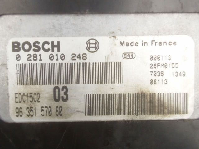

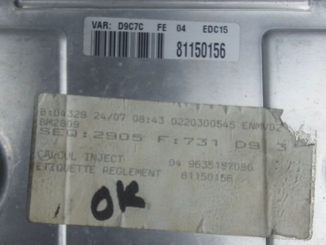

here are a few pix and video to show what this CRAZY car keeps doing, i am starting to think it is actually herby in diguise! VW's have less of this stuff!
the ecu, ***i think*** has been exchanged, as for the bsi, relays, wiring etc etc not sure...
i have removed the eng temp plug, cleaned it and the other 3 near the airbox and it still does the same, as shown in the video...
running out of time to sort this out so would be cool on any more ideas i can try, i have access to the fault tester wed again so if i need to be looking for something in particular, let me know !
on the video, i turn the ignition on and try and capture the first part of the fault, it shows a spanner, 1200 in display and the fuel light flashes, after about 5 secs the stop light starts flashing and then all the 000000's appear on the dash, about 35 secs into video i start the car (camera shake or what!) and the stop light continues to flash, along with the fuel not working etc etc
the photos of the ecu are close up to show anyone here with bish bosch experience the part / rom #s etc

i doubt vey much that the engine ECU was changed at all even if it was replaced it needs to be hard coded to the car to match the engine, bosch fuel system plus the bsi unit.
